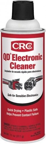

In the meantime take a look at your UFB. Make sure to be prepared:

There is a connector with a grey clip (retainer) between the door inner (front) and the body.
Google how to disconnect. Look for loose connections .Spray contact cleaner
Be very careful when reconnecting the connector. Don't want to bend any of the pins in there.
Also remove the window switch, clean and inspect. See if that works also.
