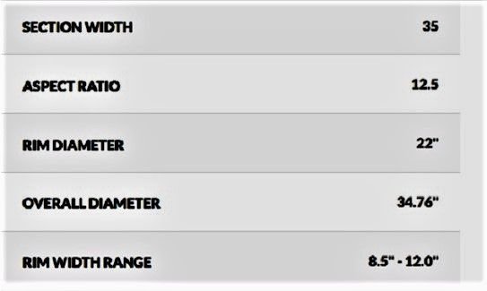

I have an '10 and I know 35" tires will fit with out mod. Yet what about the offset. I have 35x12.5x22 with-44 offset. Will it fit if I crank the T-bar or get the 2.5" key and shock extenders?

You need a wheel with the factory spec, forget about offsett.
You do not need to do anything to fit 35s on a proper wheel, like the factory wheel specs (no leveling, no shock extenders, nothing).

Thank you I understand. I am asking how to make the tires and rims that I have fit.

The factory H3 wheels are +38mm offset, You would need a large spacer (3" or so) bolted to the hub then mount your wheel to that to get the same offset, I don't know if anyone makes a 3" spacer and IMO it's way to thick to be safe, I've run 1.5" spacers with factory wheels on my 13 JKUR for years without problems. Personally I would sell the wheels you have and find something closer to factory specs.

You need to know the wheel dimensions. Width of the wheel =? , height 22", offset -44

Bassackwards. You buy the wheels to fit the truck and mount tires to those wheels.

The tires are 35X12.50R22LT, while the rims are 12x22 with a - 44 offset. I'm aware the proper order but these are just sitting around and would rather get these to fit than spend another $3000.
