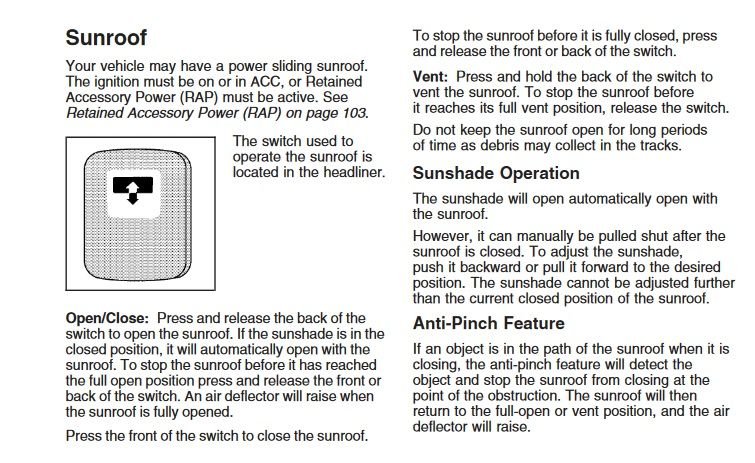

Year and Model?????
Not normal, check it out in the Owner's Manual.

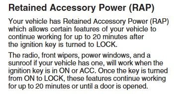

Posts: 9,015
That could cause an UNSAFE condition if the anti-pinch fails. With ignition off, sunroof switch still operates until you open a door via RAP. Someone bypassed the door switch to allow "Auto Close" without pressing the switch?

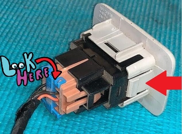

Old Aug 3, 2023 | 08:10 PM
Posts: 9,015
Originally Posted by paulattanasio
There is nothing aftermarket. All original. Is there someway to maybe do a reset?
Nope. There are 2 tabs on the sunroof switch to hold it in place, push in the tabs and remove the switch, & check for aftermarket wiring connected to the switch:
