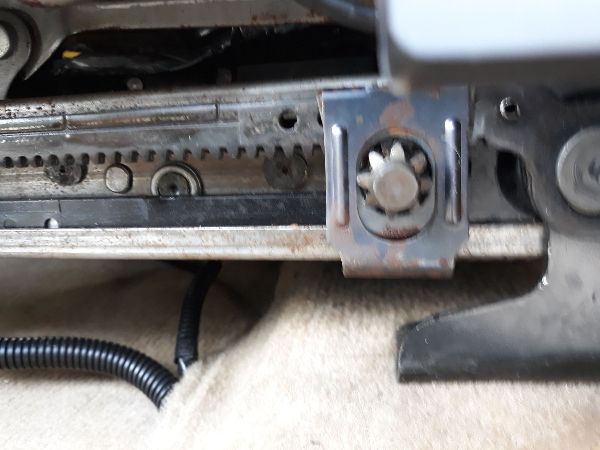

I looked under the seat first lol. The switch works fine in every direction except reverse. Not even a click to show it has a spark of life.

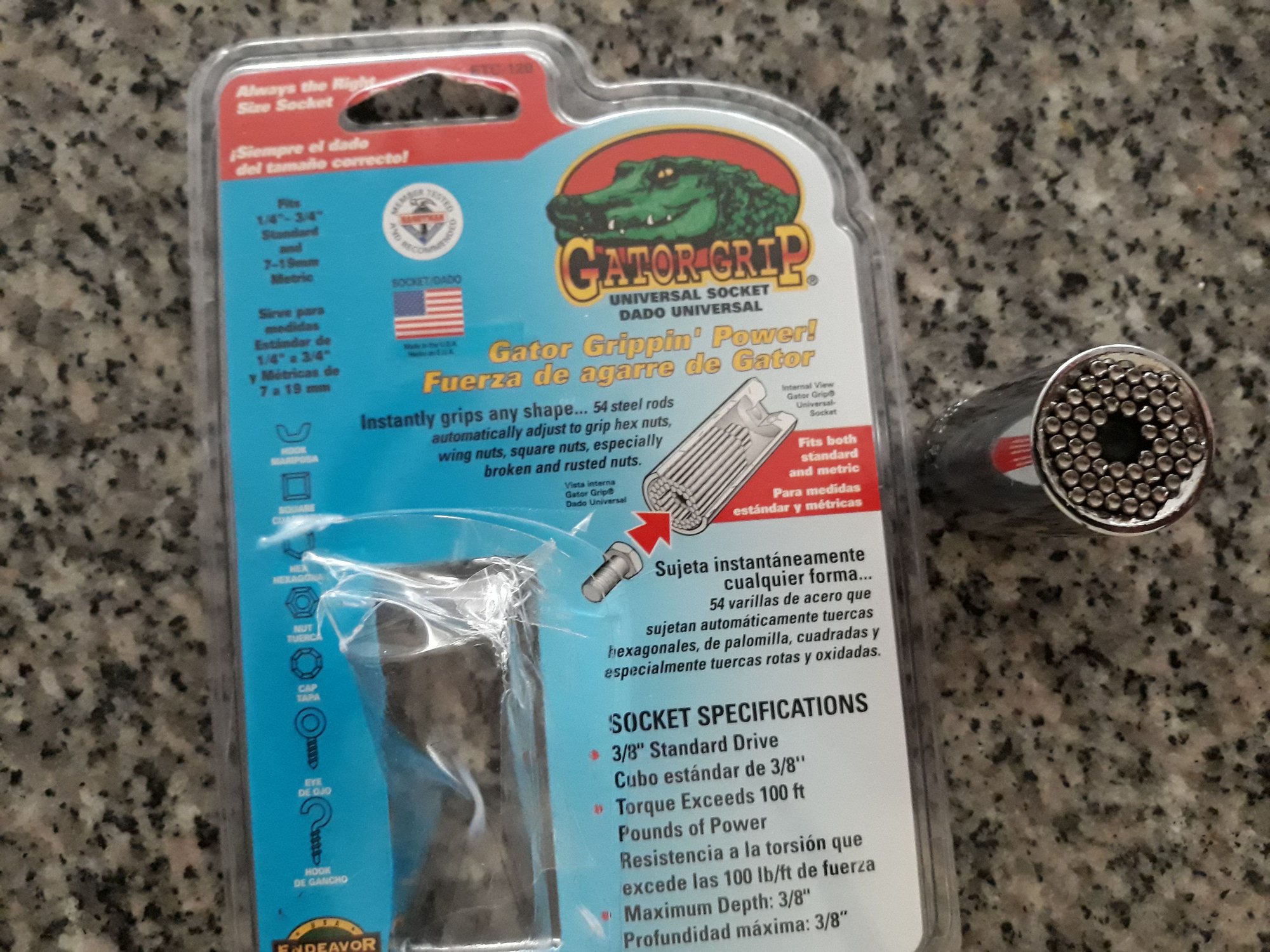

In order to get the seat back I got a Gatorgrip and applied it to the end of the sprocket on the pinion. It worked, but wouldn’t recommend it as an ongoing solution. A get me back to Florida thing.
The sprocket in question
The magic tool
