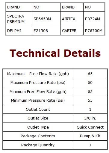

At 80 PSI the equivalent HP (high pressure) fuel pump will flow over 210 liters (50 gallons) per hour.
OEM replacement:
