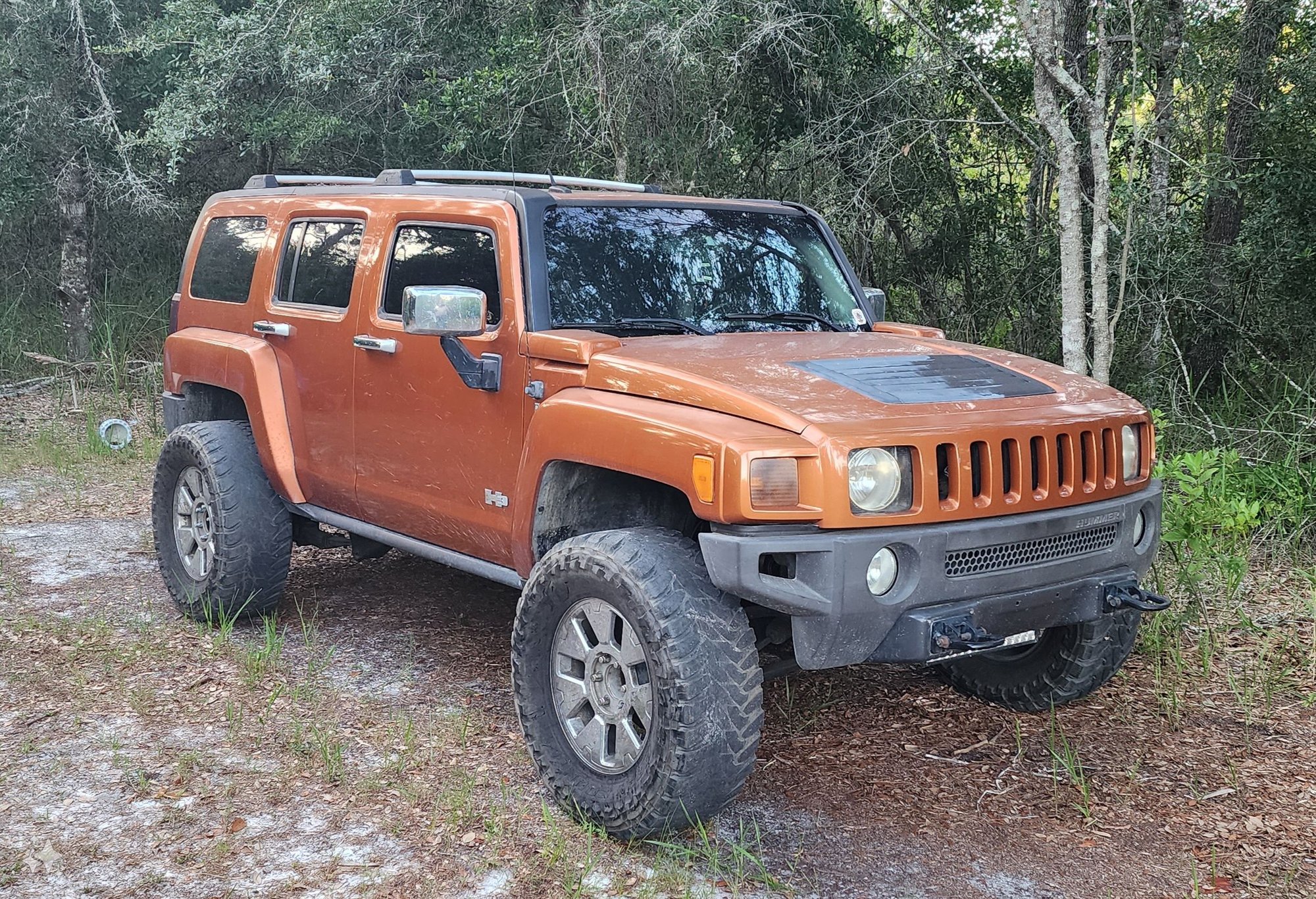

Ranger Tom, post pictures of your Hs3X ("I have a 07 Hs3X with monsoon")
Sorry should have been H3X

Work in progress

Tread overdue!

Yeas I know, I have BFG K02's sitting here waiting to go on. This is how I purchased the h3. I have the entire interior gutted at the moment fixing the sunroof drains, new seal around the sunroof glass, cleaning everything and trying to install a new stereo. Had to replace the transfer case and repair the front driveshaft.
