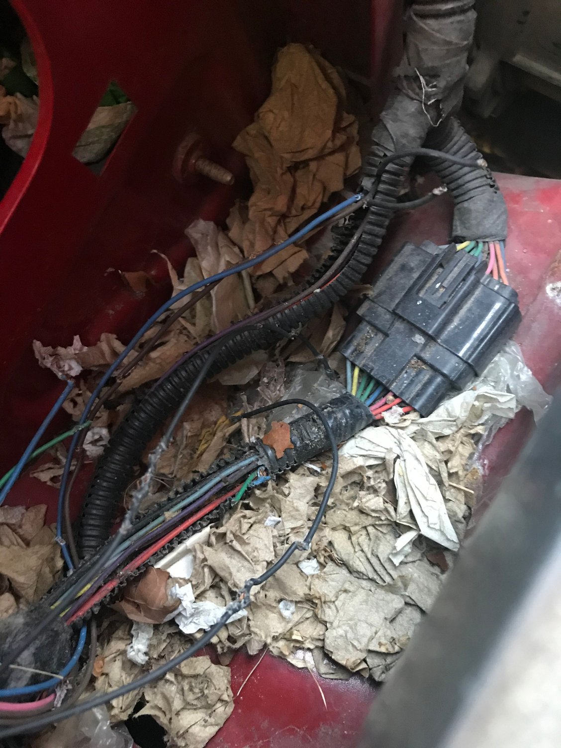

Pregnant squirrel ate some wires and had babies in there. Can I splice wires back together. Can try match them by color, is there another way to make sure they are matched ?
or replace the headlight harness ? Can I find used?

Chop the damaged wiring, get yourself a roll of the proper gauge wire(doesn't matter the color, just the proper gauge) and some heat shrink tubing. Solder or butt connect and shrink wrap the new wire/connections.

Very helpful- thank you

Agree. Its actually easy to repair. Just takes patients.

Forgot to add, after you match/repair the wires: REPEL THOSE TREE RATS. Cayenne pepper, works for me.

Lol. Firstly, I do have to remove the grille and other covers
to work easily

I like to use these where soldering is not possible for connections...

And how do I determine wire gauge when I buy. Does anyone what gauge that is?
