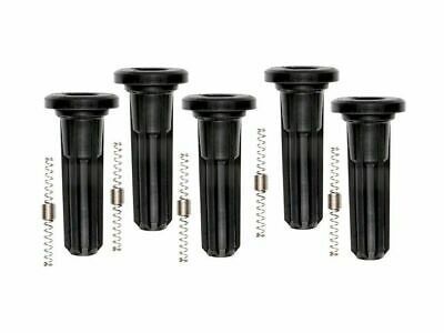

What item is in the first picture?

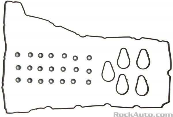

I know the second picture is the vale cover gasket.
Old Jun 12, 2021 | 04:15 PM
Posts: 9,046
Send a paper towel down the hole and extract/check the fluid.
First picture found here: Coil-On-Plug Boot

Water comes in from the front too, I got a new set of boots, many years ago, still dry inside. Get a new set, to prevent water intrusion. If it's oil intrusion, try to re-torque bolts on the vc :89lb in.(7.416667 ft-lb).

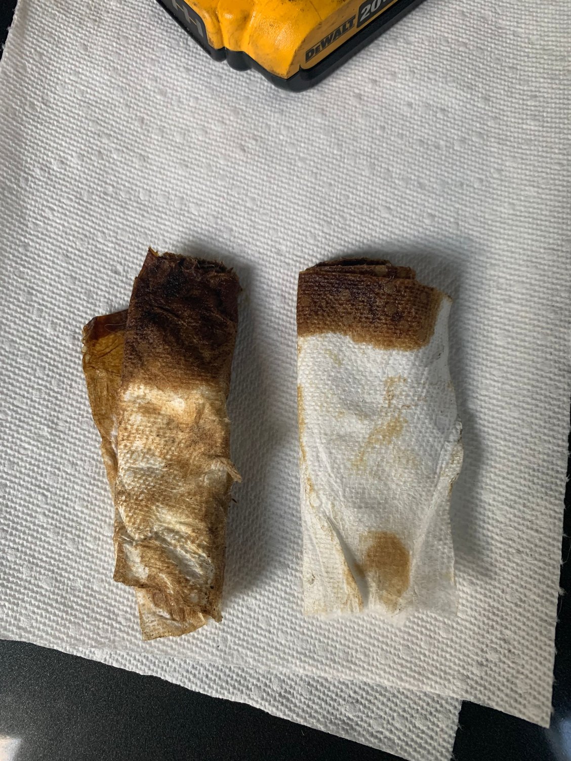

I checked the torque for all the bolts I could reach on the VC and they looked okay. More than likely the spark plug tube seals going bad.
Used the paper towel to soak up the fluid, which looks to be oil, so looks like I’ll be doing the VCG tomorrow instead of relaxing
Just to confirm, there hasn’t been any reported Valve Cover failures on the 3.7L as there were in the 3.5L right?

Old Jun 12, 2021 | 08:16 PM
Posts: 9,046
Yes, that is oil. I don't know of any vc failures? My vc & gaskets are still oem installed. I'll put that on my future to do list: Replace vc gaskets @130k.
