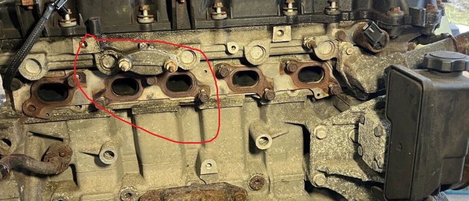

I need help identi
fiying this part on my cylinder head on my 3.5 vortex. It's cracked and seems to be leaking exhaust.

So if the 2006 Hummer does not have an EGR system, then what is that plate for? Mine is actually cracked and I can hear an exhaust leaking come from it. I need to replace it in order to eliminate the leak but I have no clue as to what it's called.

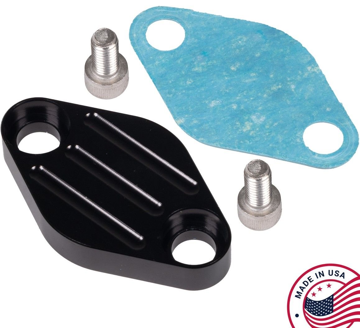

EGR Block-Off Plate
Old Nov 25, 2025 | 09:49 AM
Posts: 3,206
it is a block off plate. you can trace the old one onto a new piece of metal and replace it or use a thinner piece as a gasket and shim it.
wether it is secondary air or egr is moot.

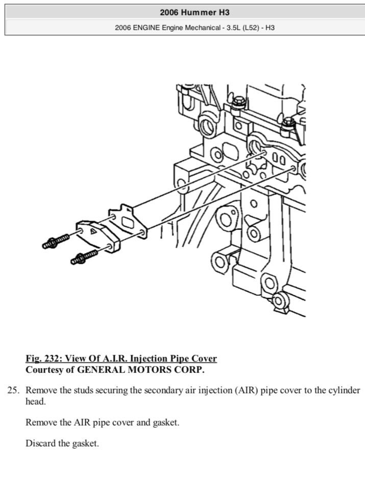

Originally Posted by sante65
My engine is totally stock.
I pulled this image from the 2006 3.5 Engine Schwartz manual. The plate in question is a secondary air system block off plate. This is the only mention of it in the 2006 manual, which leads me to believe that 2006 models did not come with a secondary air system/air pump, which is why your engine has a block off plate.
In the 2007 Schwartz 3.7 manual (not shown), there are sections that say “if equipped, remove the secondary air block plate”, which makes it sound like some 2007 models had a secondary air system, and others did not.
My H3 (2007) definitely has a secondary air system. I don’t want to speculate, but I’m guessing this may have been an addition to some of the later model 2007s, where the earlier 2007s did not have it.
Either way, it sounds like that plate is standard on 2006 stock engines.
