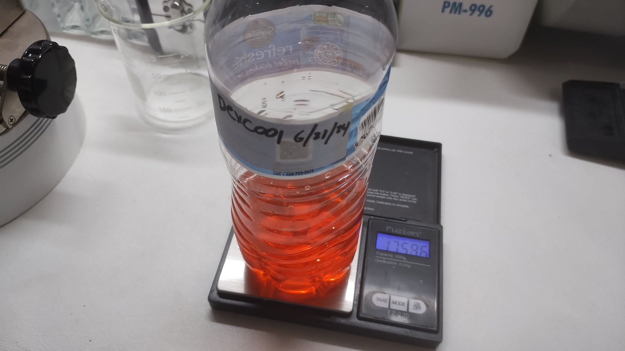

In all seriousness, DEXCOOL doesn't evaporate under sealed conditions. The overflow tank is far from being sealed. Cap is just friction fit and there's an overflow hose that vents to atmosphere. Or is there a one way valve or something on the vent hose?
​​Just for chits and giggles, I filled a water bottle with some DEXCOOL, poked a small hole in the cap, attached a breather hose and placed it into a hot azz shed. Let's see just how much water loss we get over the next few weeks.
Starting weight 175.86g

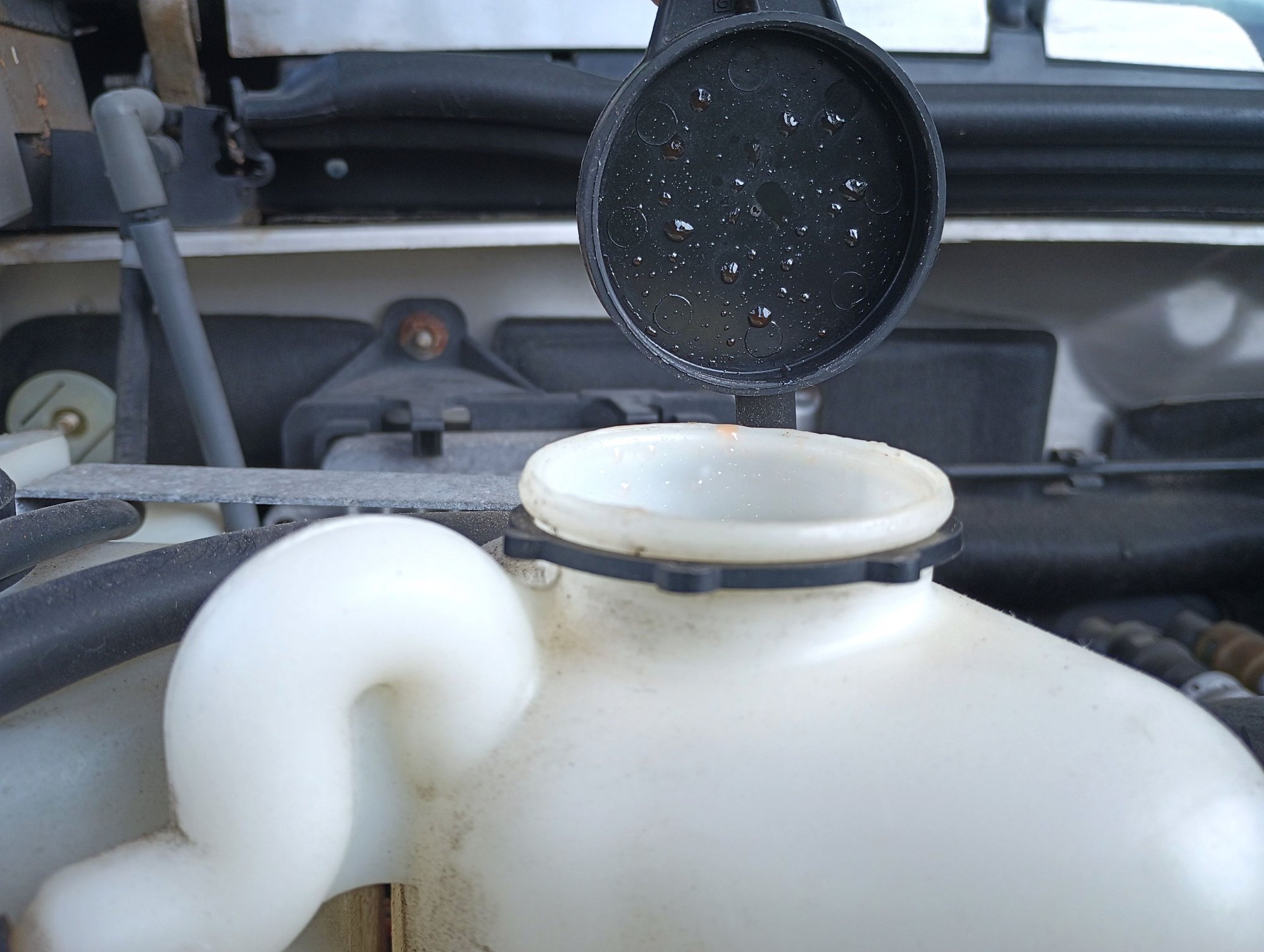

The coolant reservoir is designed to prevent evaporation. The outlet hose is there to allow the reservoir to suck air back in to refill the coolant in the engine when it cools down. I just took another pic from a different angle, currently 96°F ambient, and you can see the outlet is elbowed high above the reservoir preventing any coolant loss, yet there's condensation under the cap that will fall back in:
