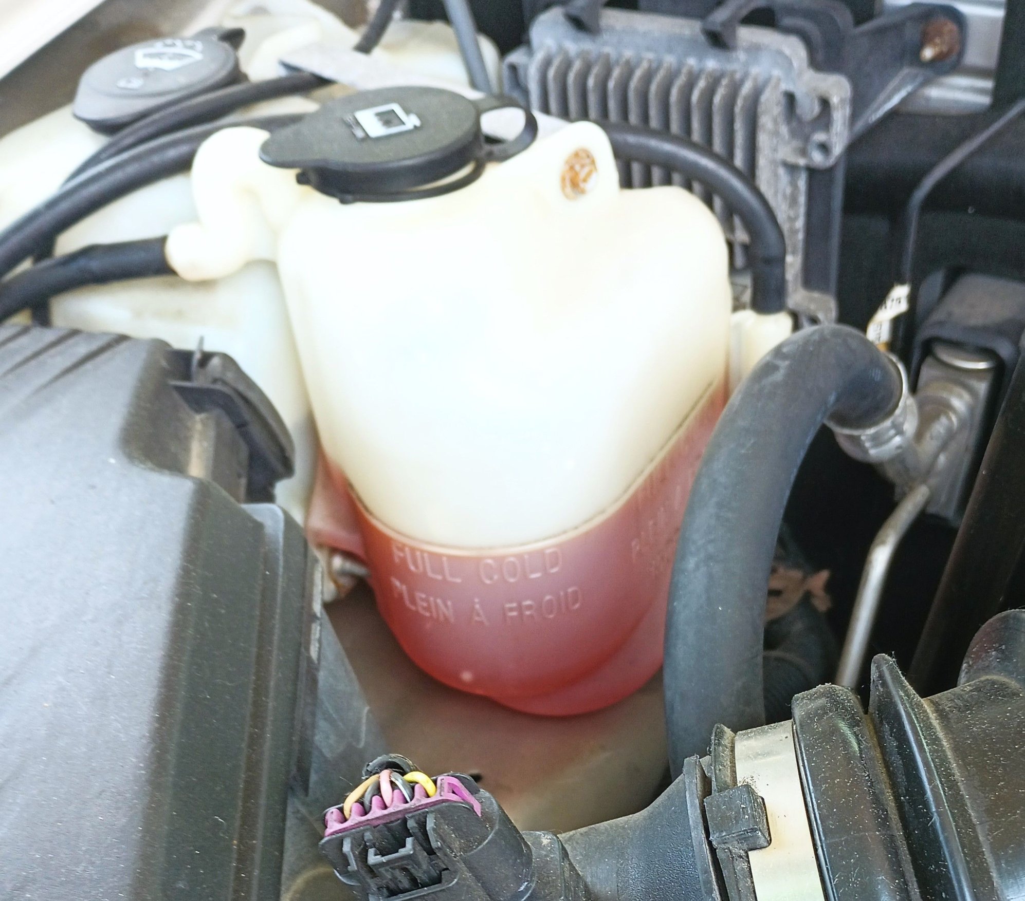

Edit: I just checked my reservoir still at the FULL COLD level @96°F Ambient, and there's condensation inside under the cap.
