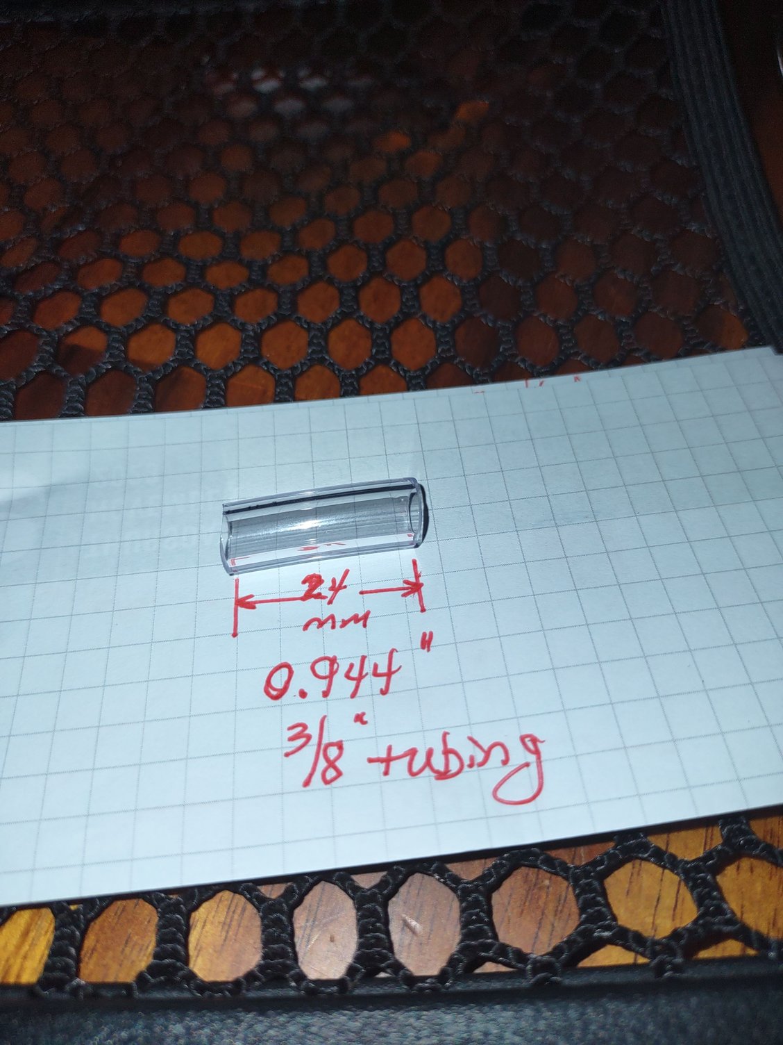

650 HAWK posted this simple solution back in 2015. My thanks to 650 HAWK as well as the other terrific forum members that offered suggestions! I spent $0.86 on this project for 12" of 3/8" diameter clear tubing. Cut each length to about 24 mm (0.944"). No specific reason for the length, just seemed to fit well. Installed the tubes inside the elastic ribbon holding the plastic snap.
As they say: "EASY PEASY, LEMON SQUEEZEY".

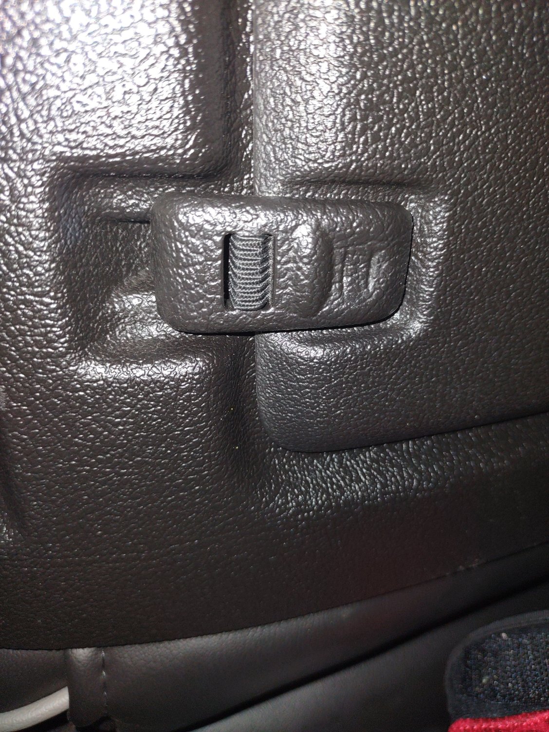

Don't understand what you mean by "...but not certain I'll be able to look at it all the time."
You CANNOT SEE THE TUBING AT ALL! The tubing is behind the black frame!

So, show me where you can see the tubing!!!

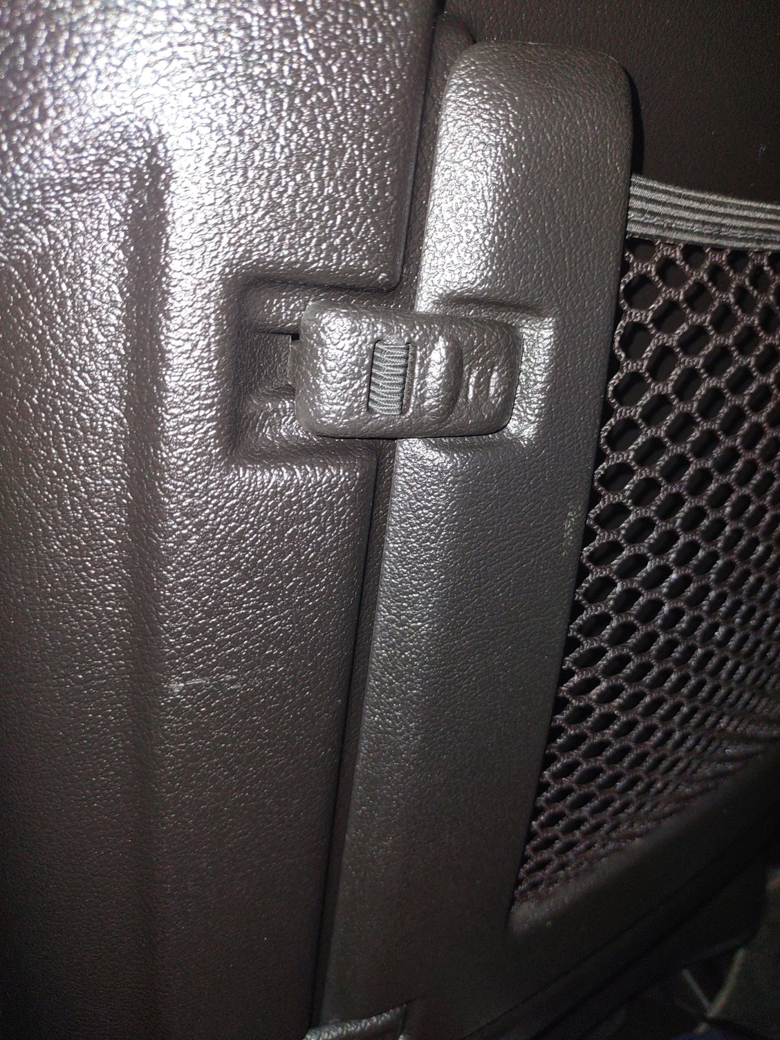

My wife and I checked Yellow Boy this evening and those two seat back Nets are still looking great and staying where they should be! We call the H3 "Yellow Boy" because he's yellow and we also like weapons.
