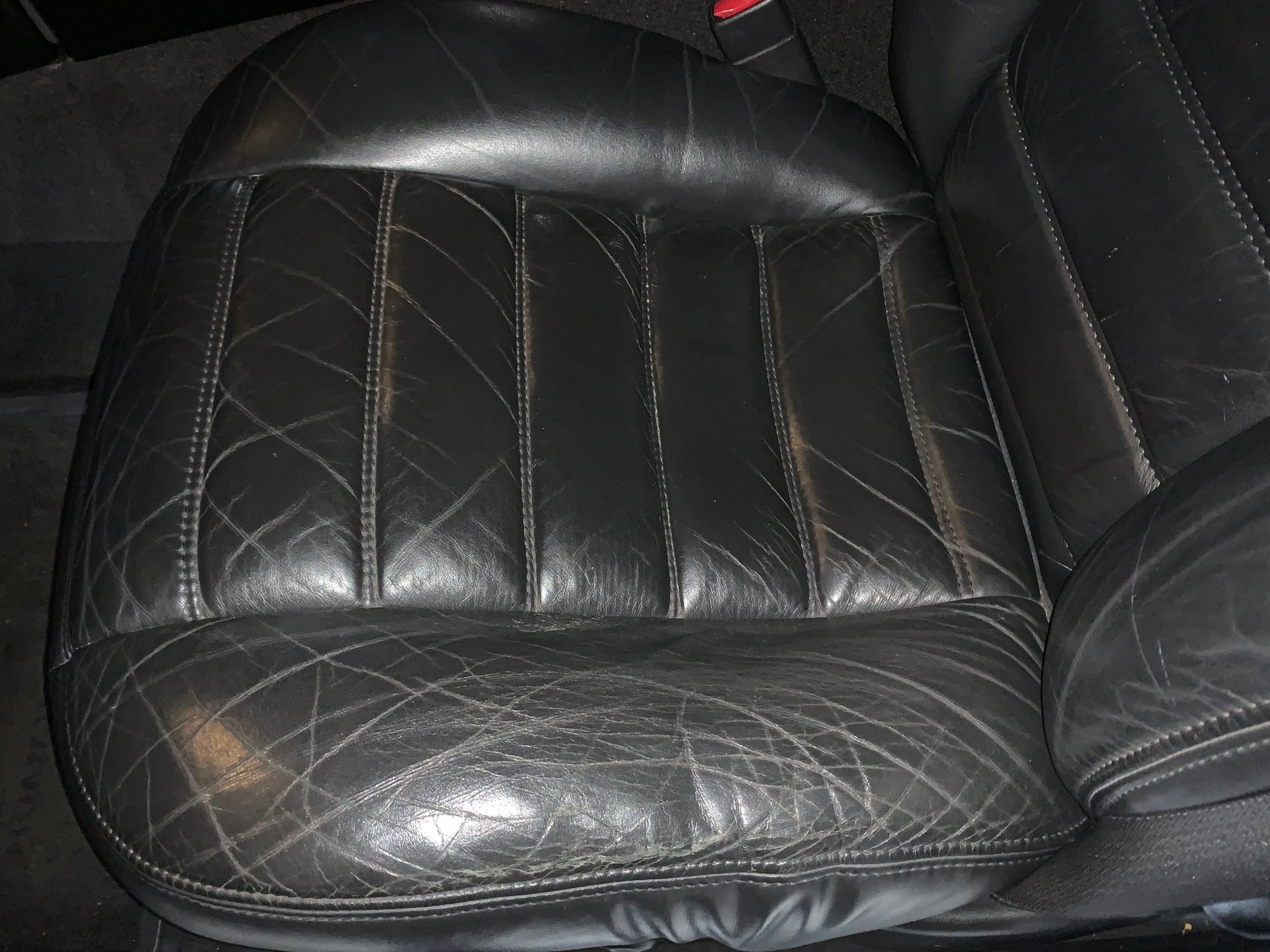

Relatively easy project, even for me. New to me 2007 Hummer and one of the first interior projects was to replace the foam and the leather on the drivers side. Before the replacement, the seat felt like I was sitting in a toilet bowl so either the foam was compressed or the springs were stretched after 95K miles. Youtube videos and this forum helped and the replacement took about an hour. Turns out the springs looked in good shape but the foam was definitely compressed. I used Dorman 926-897 foam off Amazon $70 and the fit was perfect, even the Velcro strips were in the right place. For the leather I used Richmond Auto leather for $135 and again, the fit was perfect and the quality of their leather is better than OEM. I removed the original seat heater and used it in the new seat. I tried to buy a new seat heater but the plug was different so I decided to use the old seat heater instead. I highly recommend this $200 project to anyone whose driver seat is worn out. If a newb like me can do it, so can you.

Three recommendations 1) Buy the TORX Star E-20 and E-16 socket 2) Don't skimp, replace the foam also. 3) Don't pay an upholstery shop, anyone can do this.

I recently did this job.
Not as easy as the OP makes it out to be, at least not if you do not have skills.
And the skin is not properly stretched in the photos. It was not done right. You should NOT see the felt where the seat skin touches the vertical back skin.
So do not attempt this if you are not mechanically inclined.
There are pitfalls.
For example, these skins come WITHOUT the hole for the electric seat controls.
You have to slice VERY PRECISELY an open hole, not too small or not too large to show once the controls are replaced.
Stretching can be a bear also, and requires some force to do correctly (as evident in the photo).
On top of that, the skin has crappy plastic gutters which have to be spun 180 degrees and crimp onto the metal seat edges to keep the skin taut.
These pop off easily, even after a perfect install.
Bad design.
If you are a weekend mechanic, you should be good to go
Conversely, if you do not change your own oil, do not attempt this!
You MUST change the foam pad also.
Or the new skin will very quickly crush and crease just like the old skin looks.
Final job looks great in the photos. Well done!

How did you get your cover to fit? Maybe they're better now. I had major fitment issues with Richmond leather. I ended up sending the seat covers back, they were so terrible. I even used a new gm cushion. They claimed they pattern theirs off a new oem cover.

The way you get it to fit is to buy an OEM skin. Not aftermarket. Even then you may have fitment issues. The new skin needs to be STRETCHED to fit. (As you can see was not done in the OPs photo above. )
