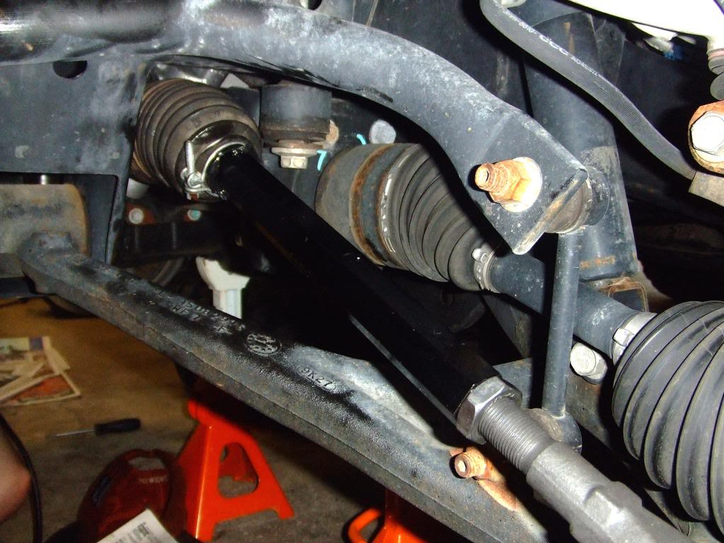

As you can see there is a difference in the size of the rod for the Tie rods. Stock is 16MM (14MM for some) and 25.4MM (1") for the upgraded units. Since there is such a HUGE difference I will call them Outfitter Design HUGE Rods for the remainder of this thread. See pix below.
Attachment 12659
You will also notice that they use the same threads for the inner portion with a larger inner rod with less milling/taper. No sloppy heim joints, NICE!
Attachment 12660
The use of the Larger tie rod outer WITH grease fittings is a nice touch also!!
Attachment 12661

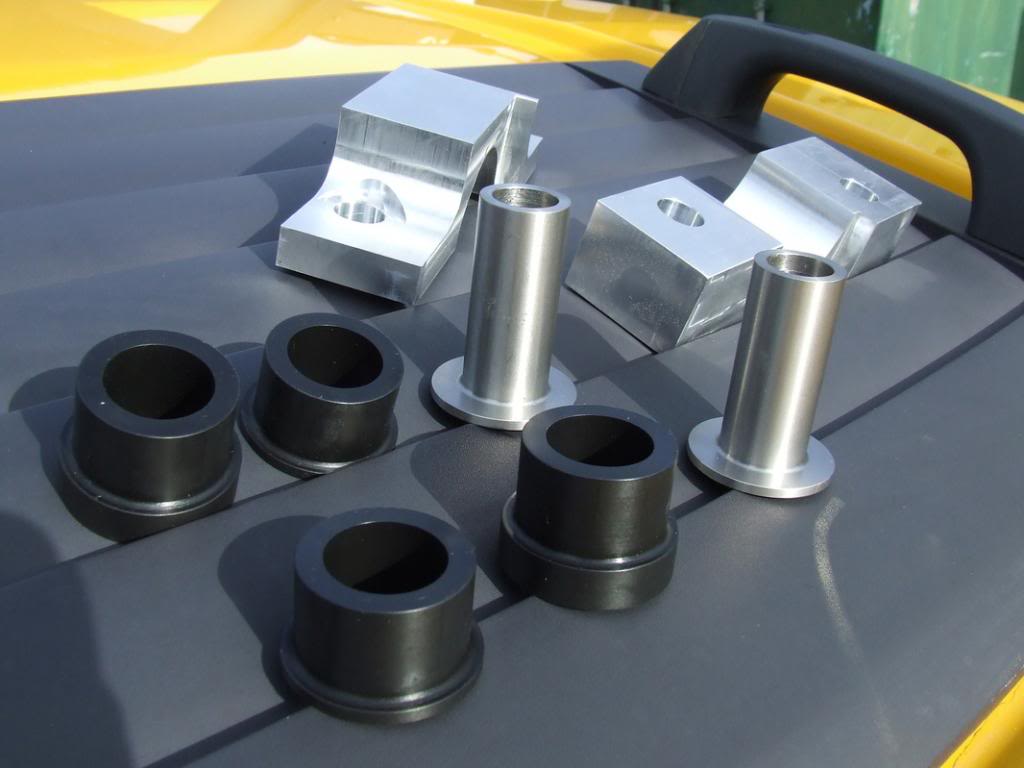

The Outfitter Designs Steering Rack Reinforcement Kit is the same as you have seen in previous install posts:
Attachment 12662
Attachment 12663
Attachment 12664
On to the install tips.
Well I really like the Outfitter Design products, but their directions and photos for the steering bracket support and bushings are not very good. Sorry, Outfitter Design guys. It is a pretty stright forward install but some of us like to read directions before starting a project in order to have the proper tools at hand.
I wrote down notes on the original directions but I am unable to locate them. Maybe they are still over at my buddies place not sure.
1st. Before you even open the package for the steering rack kit take a photo of the bushings and make sure you have the steel sleeve with the lip in the correct bushing (can't remember if its sleeve w/lip on the small side or sleeve w/lip in the large side. Also take a look at the steering rack you have removed and take photos of each bushing so you can press in the new bushing the same exact way with the sleeve w/lip in the correct locations. We did not do that and had to remove the lower bushing because the upper bushing would not line up with the bolt hole.
2nd. The bolt sizes (I wrote those down also on the same directions, oops) are not what they are in the directions (I believe they list thread size????). Anyway, get the proper sizes before you wedge everything back up inside there. :headbang:.
3rd. Measure, measure, measure. First center the steering wheel and secure it with a ratchet strap to the brake pedal. Measure: Outside front tire to tire, outside rear (of the front tire) tire to tire, driver and passenger steering rack to tie rod bolt center point, tie rod center bolt point to tie rod bolt center point. These measurements will aid in getting really close to your original alignment specs and have a straight steering wheel.
4th. Removal of the driver side wheel well plastic liner will help greatly in removal of the lower steering link bolt.
5th. If you don't know how to remove a tie rod you probably shouldn't be doing either one of these upgrades by yourself. No special tools just basic knowledge.
Whack with a large mallet here, that should release the tie rod end.
Attachment 12665
Pix of the lower steering link and bolt (you can actually see them in these pix)
Attachment 12666
Attachment 12667
Outfitter Design HUGE Rods can use the original boots but you must cut them at the smaller nipple end.
We had to use some clamps and zip ties since the original clamps would not fit on the Outfitter Design HUGE Rods.
I am sourcing steel clamps, when I find them I will post them here.
Attachment 12668
Attachment 12669
Almost the same size as the half shaft!!
Attachment 12670

The upgrade of the Outfitter Design Huge Rods as well as the OD Steering bracket AND bushings has changed the entire way H3 handles. No more slop! You will have to "relearn" how to drive your rig. Slight motions in the steering wheel will actually make the wheels turn now!!! Still a great ride just more feedback at the steering wheel and the reduction in bump steer is amazing. Not totally gone but greatly reduced.
I had a few people ask me if I thought they are worth the price.
Steering bracket and bushings-YES!
OD HUGE Rods-YES! Especially when you think about the cost of a complete set of OEM 16MMs. Definitely worth it.
