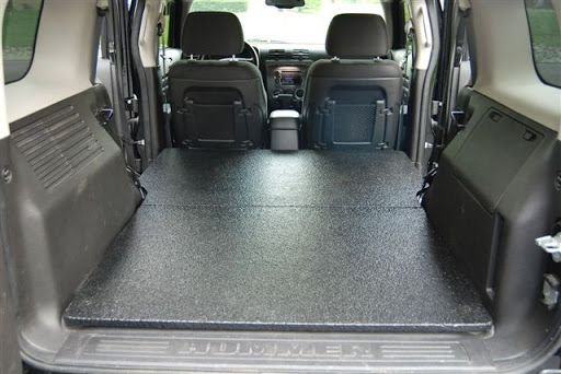

Rear seats can be removed and are separate from the backs(4pc).
Removing both seats and backs you can do this:
Or you can also keep 1 seat installed:

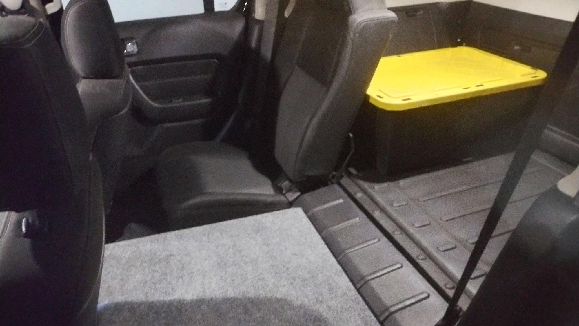

How do you remove just half the back seat and keep the other one installed?

WOw, I searched the web up and down and couldn't find anything. How I came across this old azz thread (sorry Doc, I know how you feel about digging up old threads). I swear Google has been awful lately. Hummerz is a better source of information than Google 😂
I end up taking the entire seat assembly out, removing the center nut and a torx bolts from the hinge. I did not cut the bottom plate in half like the video. Just bolted everything back without the left driver side half.

Here a few photos, bonus photo of the camp site. Getting rid of that left seat made a big difference in storage capacity and fits a single air mattress perfectly.
What's the material you used in the picture with both seats removed? Is that foam of some sort? I saw a yt video on how to remove the rear seats and backs, and there's a dip where the bump would be when the rear seats are down normally. I want everything flat like in your picture. Thanks for the info.
