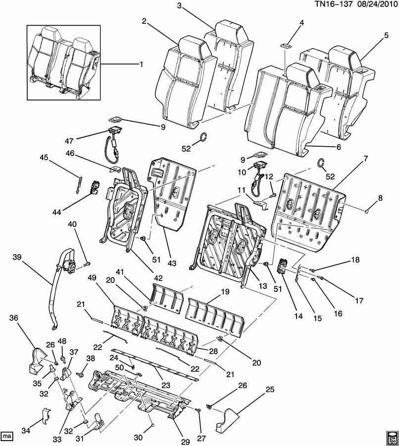

Has anyone taken the rear seat back apart? Like take the 60 part off from the 40 part? Im thinking it has a rod that runs thru both from one side to the other but cant find a diagram of it on the web
Old Mar 13, 2022 | 06:44 PM
My rear seats are in 3 pieces wrapped in the back of the garage, keep them out, and only reinstall when needed. Diagram for the backs:

So im guessing the seats cant be separated to remove one and add a new one back without destroying the rack. Guess ill check into how to just remove the cover and replace it and the pad.. thanks!
Old Mar 14, 2022 | 04:25 PM

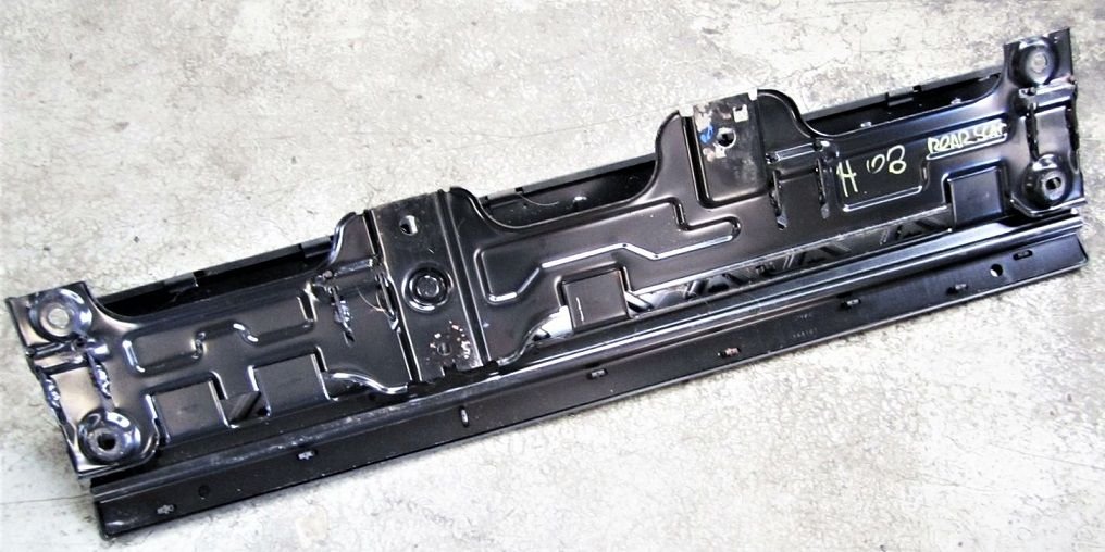

Yes, look at the diagram, the seat backs are bolted/attached to the hinge plate(hinge plate covers 25&36 to access the bolts). I plan on taking mine apart, will post pictures. Btw, there's a hinge plate UNCUT for sale on EBAY:::>>>2006-2010 Hummer H3 Rear Seat Lower Shield Cover Trim Panel OEM

Thanks a million hummerz, i got them apart and it was amazingly simple, the outside plastic cover has a phillips screw and one of those hateful clips, then under that is a single T45 star bolt, then popped the plastic cover in between the seats and removed the 15mm bolt and apart came the seats.
