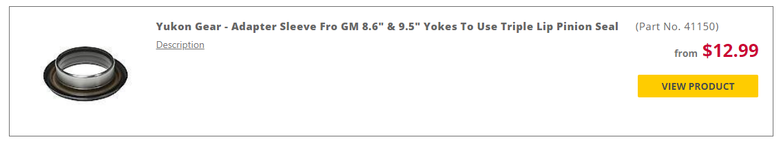

All went well, except I discovered there was a sealing surface sleeve (name?) on the yoke that the seal seats on. I'm sure it's designed to be the wear item instead of the larger yoke.
However, no parts stores, and not even the dealership listed this part. I used my old one out of necessity, and it still worked (no more leak), but I'm wondering if this is even available? Maybe it's just a generic part I'm not familiar with....? If it starts leaking again I'm going to want to replace it...

Answered my own question after a lot of searching. Advanced Auto has these:
https://shop.advanceautoparts.com/fi...ntial-end-yoke
