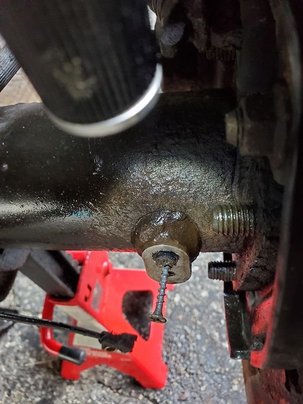

A bit more PBBlaster and muscle and clean up and now able to snap it out twice but it still gets stuck once partially out and so far no luck. Sprayed it again and will wait a few minutes. If I do get it out should I do any cleaning etc or just stick the one one immediately to make sure nothing gets in there?
Old Aug 16, 2020 | 03:46 PM
  #22
Posts: 9,015
Your getting there.. Clamp on a pair of visegrips on the screw closest to the axle and carefully pry on the visegrips with a screwdriver/prybar..all debris should come out with the sensor, once its out, lubricate the new sensor and carefully push it in, until it's flush, then bolt it down and connect.

how do I lubricate the new sensor ? lol I finally got the old one out with pliers on the screw. I just put the new one in without lubrication.... I am guessing I will need to drive out to get whatever lubricant will be needed, can you suggest a product?
Old Aug 16, 2020 | 03:59 PM
  #24
Posts: 9,015
No. if the new one slid in, you're good to go. Bolt down, reconnect and properly secure the harness, then clear the codes. Nice work.

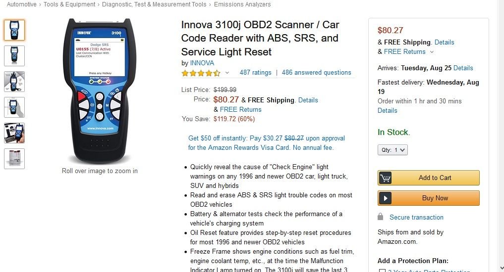

Can you suggest one ? I could not find one under $100 and did not feel like it warrants purchasing for a 1 time occurrence. The scanner I have always worked fine for all other issues.
Old Aug 16, 2020 | 04:49 PM
  #28
Posts: 9,015
You have an '06. a scanner is always useful, to help you diagnose.
Here's one, with SRS too, under $100:
Amazon Amazon
