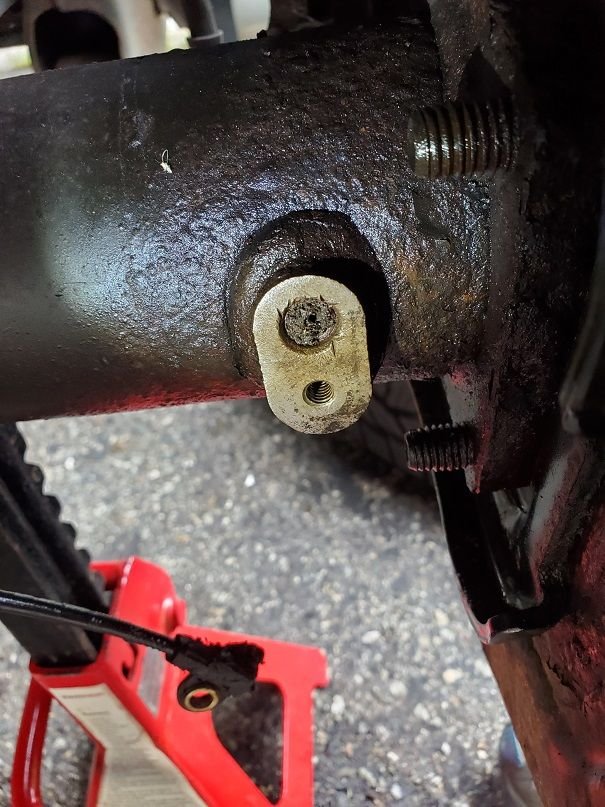

Well I took ur advice, as suggested the top part broken off. I used a sanding disc on my grinder, some sharp knifes, a screw driver and it looks like all rust is off.... but the damn thin still will not budge..... I will try some pb blaster and continue at it.
Old Aug 16, 2020 | 12:49 PM
Appears you have the surface clean, yet you have to remove the rust from the hole. Post a picture.

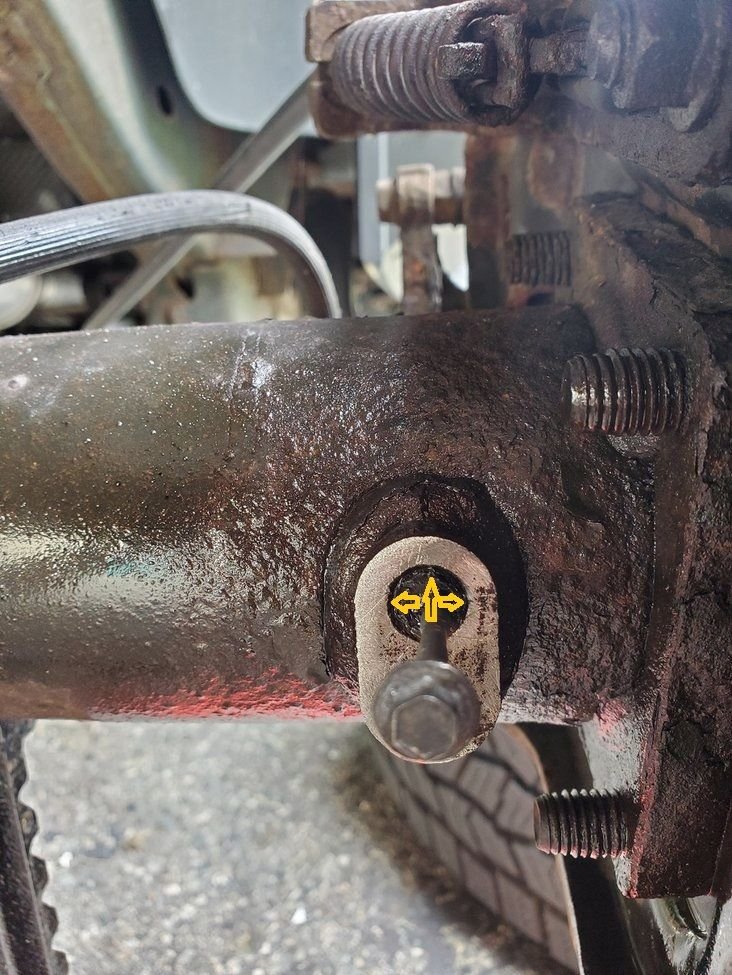

Here it is, not sure how much you can see here, I did spray it with pb blaster a few minutes before taking the pic.
Old Aug 16, 2020 | 02:35 PM
Yes, scrap around inside the hole. Looks like you have the screw secured into the sensor, should move back and forth, push it in and scrap/sandpaper around the outer part inside of the hole. If it breaks apart, you will have to flush/drain/clean the diff. Patience, it will come out!

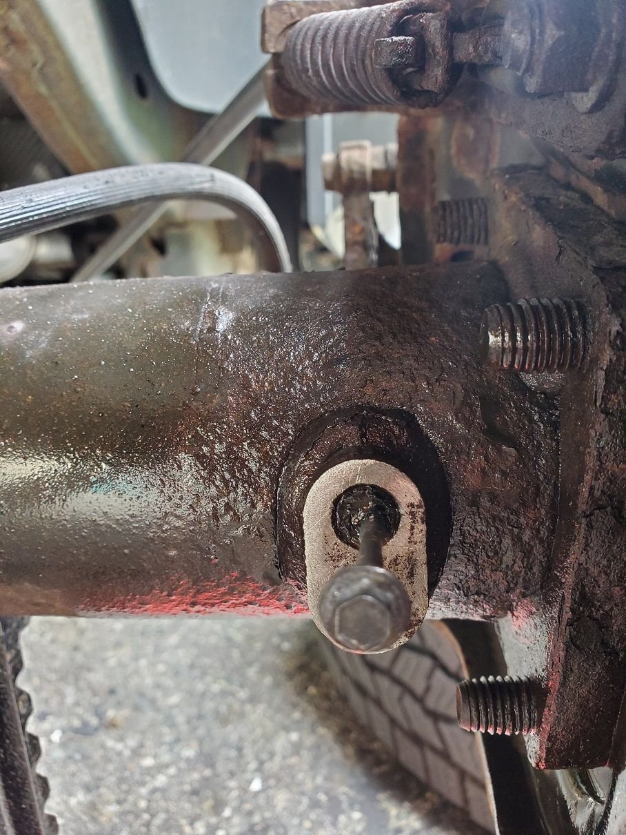

flush clean differential? sounds very painful and perhaps above my paygrade any vids or articles on how to do that? you are scaring me a bit.
Old Aug 16, 2020 | 02:54 PM
Originally Posted by Raffi76
The hole looks better. Insert the screw... Does the sensor move inward and outward?
Old Aug 16, 2020 | 03:27 PM
Raffi76's Avatar
Joined: Jan 2006
Posts: 474
From: NJ
at that point it did not but i did a bit more cutting with my knife and when pulled really hard the blue gasket started to show. I was able to pull it out and now when I pull really hard the sensor does move out a very little bit. It almost feels like its stuck, then it suddenly pops out an eight of an inch (or so) and then gets stuck again. No luck so far to pull out after the initial snap out. not sure what else to clean here as it looks clean enough. I am able to push it back and in and out again with quite a bit of force still but not all the way out.
