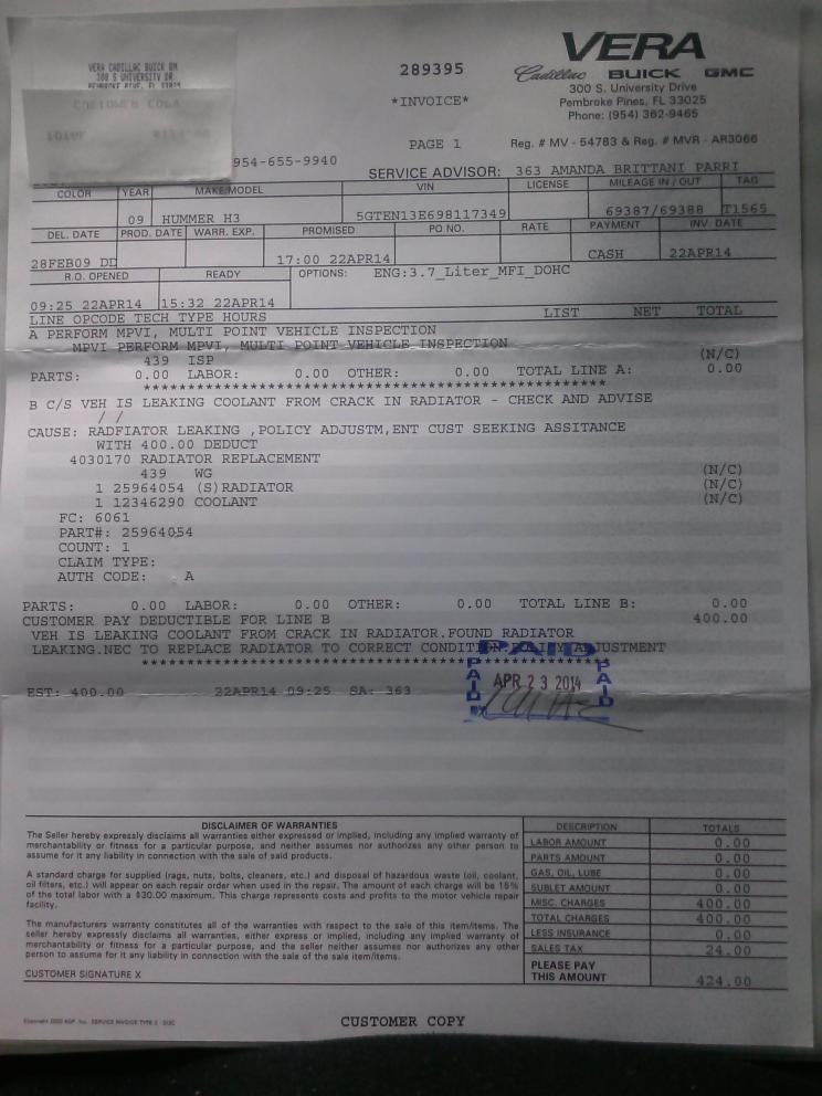

Hey guys, at 68k miles my 2009 H3 just developed the dreaded leaking on the top seam radiator failure. I read most of these posts, mostly looking to find an all aluminium replacement. Im of the idea that if i know the design is flawed, then why buy it again? Unfortunately the only option i found was a custom made model for 1k dollars. More than i would spend on a part like this. Next i considered if i could have the dealer replace it and only charge a 100.00 "dealer fee" That i would be happy with that. Called 3 Cadillac dealers here in my SF area and they all told me that there was no recall, so if i was looking for GM to cover some of the expense that i would have to call them and see. That it was on a case by case basis. Called the 800 Hummer number that i found online and was asked for info name & number, address and vin . Then was told to take it to my usual dealership for evaluation, afterwards to call them back to see what they could do. Is this a waste of time ? If it is i would rather just buy the aftermarket replacement and have my machanic intall it for me.

Wow! Its just been 2 hours since i called GM and looks like its resolved. My local Cadillac dealer called me to say that their supervisors from GM had called them because of my complain and that they would replace my radiator, out the door for 400.00. It's not the 100.00 i wanted to spend, but its better than the 800 plus that they would normally charge. I am going to take it and run. Happy camper !

Or you can call this number 866-636-2273 and complain, you got nothing to lose and you may pay half the price (400.00) like i did. Im including a pic of my bill from the dealer.
