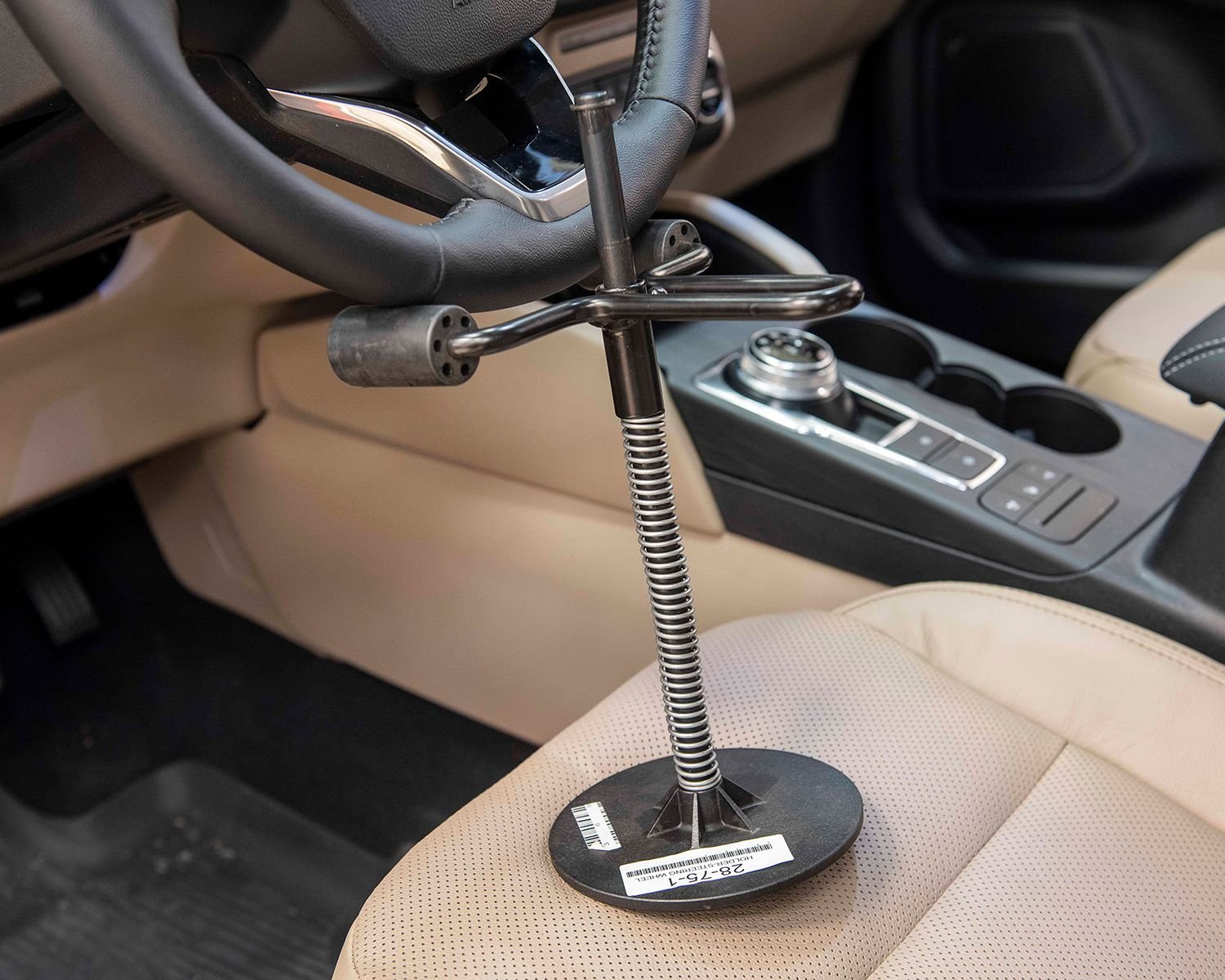

Much appreciated. And yeah, I've definitely read just how important it is to lock the wheel so I will make sure that happens. Almost bought the GM tool that the manual recommends but didn't want to pay/wait for shipping. I'll try to grab some pictures or maybe even put together a video and post that once it's done and add them to the thread.

Yes, needed for shops that do many alignments daily. DIY, after centering secure the steering wheel with cargo straps/bungee cords/duct tape, etc.. make sure to secure center before disconnecting the rack. Then make sure new rack is centered before install. With steering wheel & rack centered, move outer tie rods as needed. Measure inside distance side to side of the tires(front/rear), should be 1/16"-1/8" less on the front (TOE) GL
