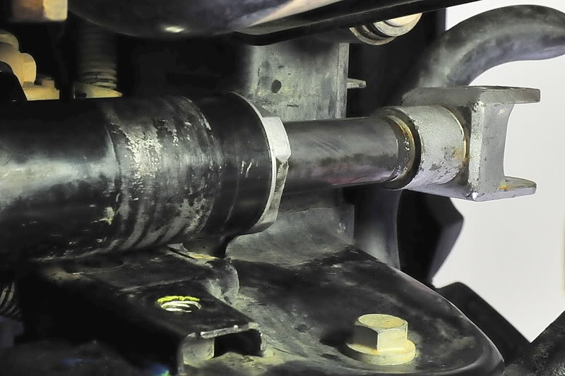

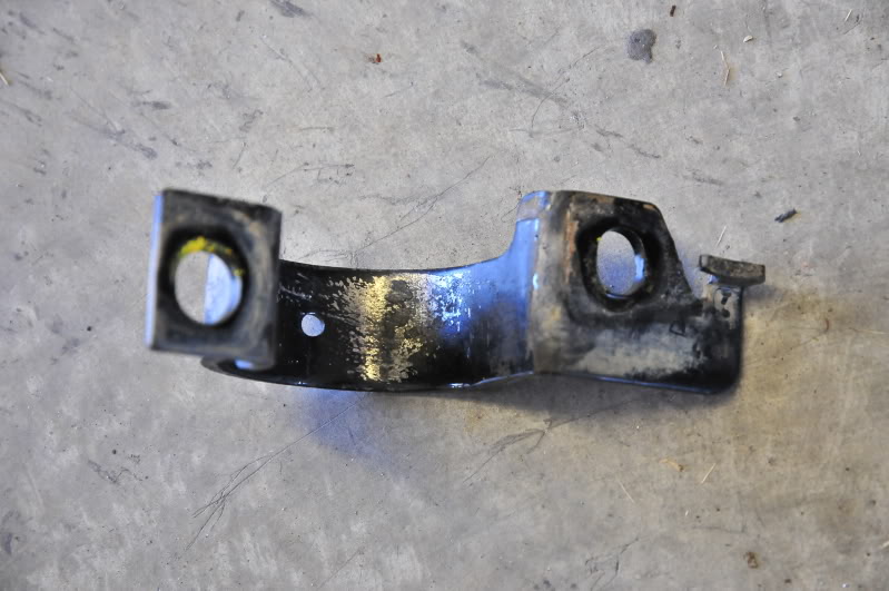

Replacing the rack will not fix it except the new rubber bushing they will install.
The rubber bushing failing will allow the rack to move around in the bracket and rub the paint off of both. If you get the sleeve tight it will not move.
Later I will post a more detailed method of getting it tight. There seems to be some variables depending on how long you waited to do it and the condition of the bracket. I have a couple of different thing to try and it works.
Here is a rack and bracket where the rubber bushing became distorted and wore the paint off.
paint is not a problem, it's movement which can break the rack.
