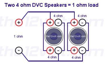

1. If you want EARTH SHATTERING & EAR SPLITTING BASS and don't care at all about sound quality. Keep the krappy head, install 2 krappy 6.5" 3-ways in the front doors, forget the rear doors you ain't gunna hear them anyway. Put a giant azz bridged 1 Ohm stable amplifier in the rear attached to 1/0 welding cable to the battery to a HUGE 6-7 Ft^3 Ported sub-woofer box with TWO - DVC 4 Ohm 18s and call it a day.
