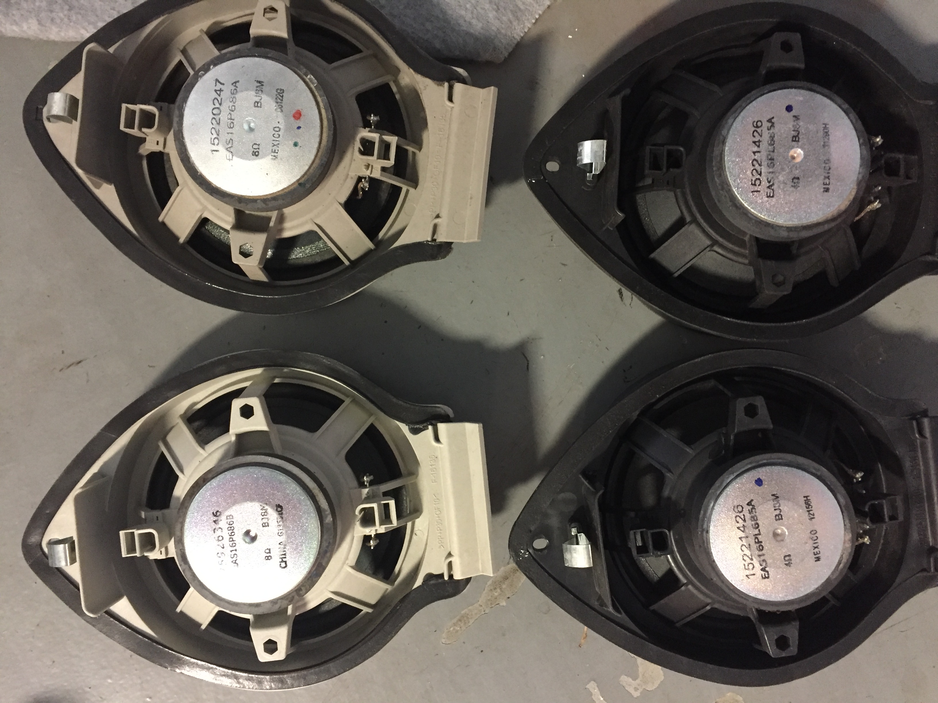

When we removed all of the speakers the fronts only have 4 ohms but the rear ones are marked 8. (I think the pic download.)

Finally got my speaker pic.. anyone realize the ohms are higher in rear speakers?

I wonder if the 'A' pillar tweeters are also 4 ohm and wired in series with the front door speakers creating 8 ohms and producing a match with the rear door speakers?

Ah maybe you are right.. that seems to make more sense. I'll try to find out. Thanks

Ok Broken Halo, you are correct.
Still told to stay at 4 ohms tho.
