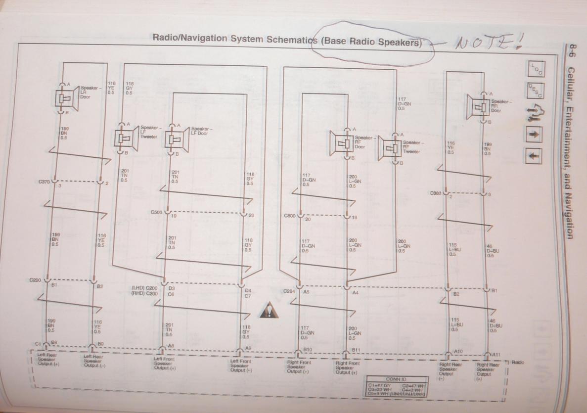

Dr Tom - parellel or series, with a passive crossover....it limits the Hz frequency. Depending on the filter, it will restrict mid or low frequencies to any tweeter. Component systems work in the same fashion. Tainter is DEAD ON. Also, people do pay those prices. Those who expect quality sound at ANY level. Also, 3db is a barely perceptible change while 5db is clearly noticable change.

ifn u look real close at ure wiring diagram for monsoon,and elcheepo,u will see how the tweets iz wired,,,or my book just printed that page rong.
maybee i can get a picture 4 u
i really doubt anyone could detect the diff in those spensive spks and walmart. have you seen what wally sells in spks ?
if i get pics u will see tweets conn direct to amp,,no crossover is shown.
dont know how they are driven??
btw i have a pair of hugh heath 1648 three way spks and 2 cabs i cloned with crossovers..be assured i know how coils,caps make tuned circuits/filters/hi pass/lo pass/band pass/notch,,,,

heres what my 07 manual shows. tweets in parallel. and thats the TRUTH URE LOOKIN AT!!!
i must admit i was stunned when i first saw this last year when a question came up. i think it was discussed then so im surprised at the big deal made about it now.
i think the cheep radio prob doesnt drive them too hard,,or they get blown and nobody notices!! do you know for a fact that your tweeters are working??

How do you think they seperate the frequencies then? Is it the flux capacitor in the difibulator x package dongle near the knee twister? Just because they are not on the wiring diagram, does not mean they don't exist. Does your wiring diagram breakdown the parts of each speaker as well????? hmmmm?

Also, you'd think if you've built custom clones in the past with the use of crossovers, then you'd think you would understand the importance of seperating the frequencies on respective speakers. Who in their right mind would send a 50Hz signal to a tweeter in parellel? They would last for about 2 minutes.

I was a sound quality/installation judge for IASCA for many, many years and owner and installer of competition systems for even longer. Having built a sheet ton of passive crossover networks with anything from 6db slopes to 24 db slopes I KNOW (as you do) that there is a passive crossover in line somewhere.

the stuff i used yrs ago had caps AND coils to make a real crossover. i can send pics of that too.
you gotta admit the diagram is pretty convincing huh??!!

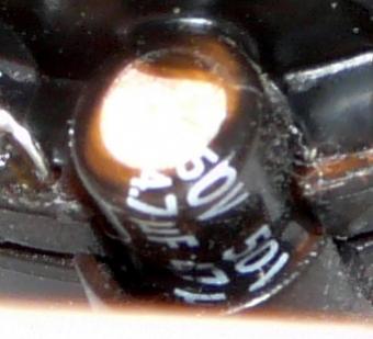

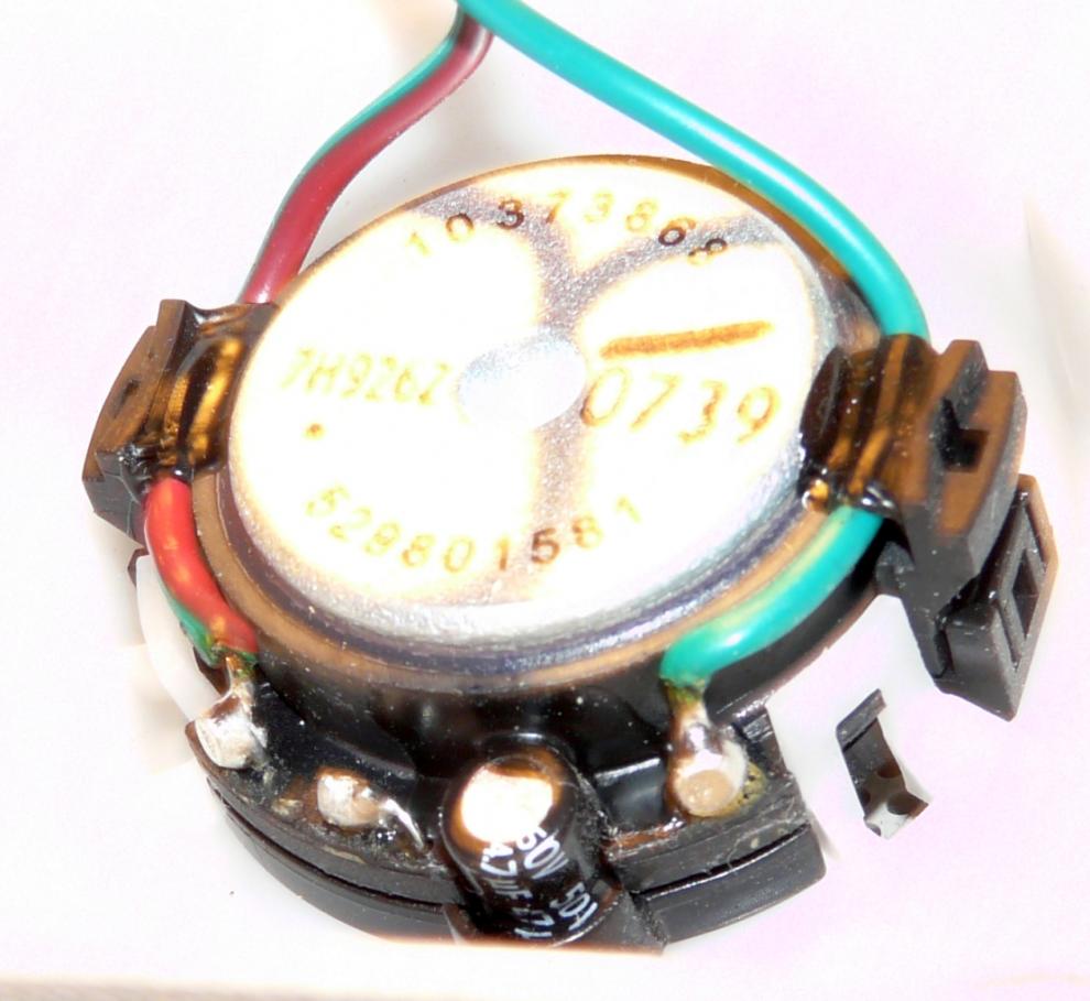

so i pulled the left side tweet trim out and looked,,,real hard and indeed there is a tiny 4.7 mfd cap hiding in the plastic housing,part of the tweet. its a cheap and dirty way to get some freq split but not what i envisioned as a "crossover network"!!
so if you look only at the official gm service literature you will see nothing resembling a network. just wires and a symbol of a speaker identical to the other speakers.
the cap;
its hidden, i found it, pics to follow

the proof! hidden cap. you were right it was "somewhere"!
edit 10 20 pm, just for fun i went back for this, from taint,
For those of you who do not have the stomach for an online disagreement, WOW! If you just want inaccurate information with no real fact checking, I guess this forum isn't the one you are looking for. I am sorry, and not for the disagreement.
so he knew it was in there ,,"somewhere"!!, but HE did no fact checking!!, i did.
i was working with facts,the diagrams that showed nothing but direct wires,and separate wires for monsoon tweeters.
the question still is, why separate wires if the monsoon tweet has a cap for crossover just like the base radio.
its misleading and people who dont fact check, who make stuff up mislead and confuse the issue.
