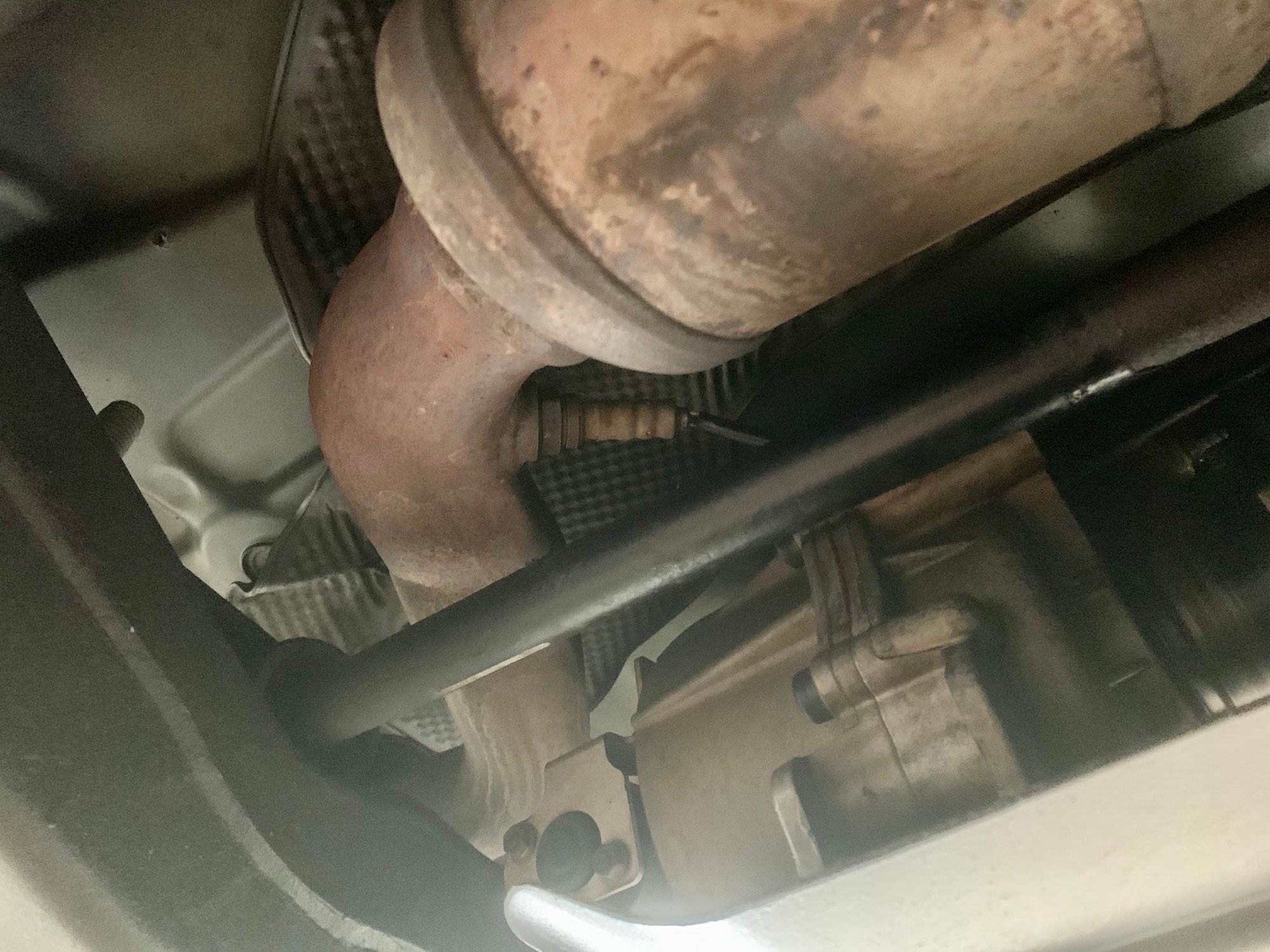

Honestly I don't know enough to know if it has an aftermarket exhaust or not but it does not appear so.
There is one way high that gotes through a hole in the heat shield. It has a wire.
One about a foot down that has the wire cut off but it is clearly an 02 sensor screwed into a hole.
There is another behind the cat way back by the transfer case that has a wire.
We are not getting any check engine lights

Post a picture of your downstream sensors.
upstream here:
I am trying to get them from my phone to here.
I have that one then there is another just before that bend that has the wire cut.
The other one that is wired in is right behind the converter way back by the transfer case.

Old Jun 28, 2020 | 08:23 PM

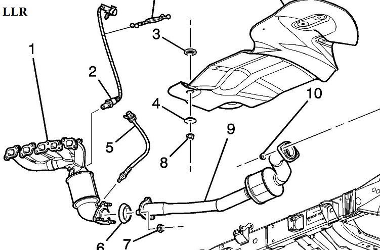

OEM, o2 sensor location(#2 & #5, L52vsLLR):

What I have looks like L52 with a plugged bung at #5 on LLR. What does that mean?
