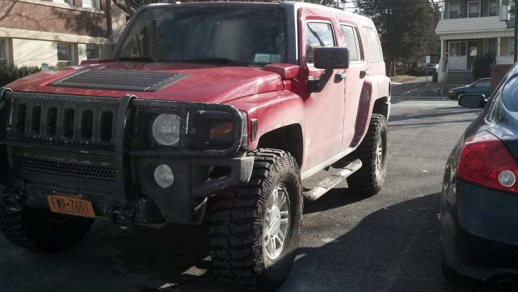

Originally Posted by SYNERGY of Sparta
De-chroming the grille and tinting is happening friday... where can I post pics?
...can I upload them to this sosite?
yes you can, using something like photobucket

Here's mine with the Daystar 1" body lift, torsion bar adjustment and on 35" Goodyear Duratracs.
