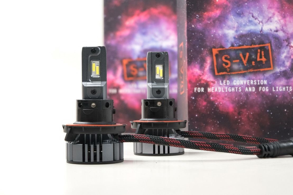

The OEM reflector design is not so great, you can put Vibranium nuclear powered lights in there and still not have great high beams. I went with S-V.4 hi/lo H13 headlights and single fogs, crazy bright and limited only by the OEM bucket.
Consider that modern high beams are not actually brighter than lows (not supposed to be), they simply change beam pattern to shine off a different position of the headlight Reflector to aim the light higher. Back in the day high beams were briter as a second filament lit up while the low stayed on.

Doc, are those available at regular jobbers like AutoZone, O'Reilly's, NAPA? And how much?
Thanks, Greg
Old Jul 25, 2023 | 01:32 PM
Thanks, Greg
Nope. On line and PRICEY! Like $180 for the headlight pair. Scored a little bit better than that off ebay by being patient, but still up there.

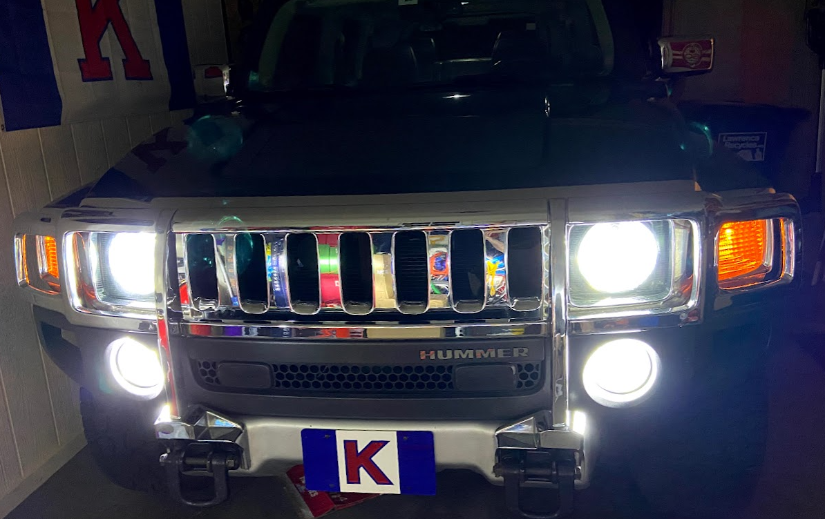

Not sure if you're still looking @GregL, but I grabbed some
BEAMTECH H13 LED Headlight Bulbs 16000LM 70W 6500K on Amazon BEAMTECH H13 LED Headlight Bulbs 16000LM 70W 6500K on Amazon
back in September 2021 for $31 total and they still seem as good as ever. Looks like they're a bit more expensive now ($43+tax). Install was as simple as replacing with another halogen and I did not need an LED resistor like some did to make it work properly. Would recommend these 10 times out of 10. Had the Silverstar Ultras, then their ZXE Gold version and took those back immediately. It's damn near impossible to grab a reliable picture of car headlights but here's one with the driver's side bulb installed and ZXE Golds on the passenger side (halogen fog light bulbs, too):
Now here's a picture of both BEAMTECH LED headlights installed, as well as their matching
H10 6500K fog lights H10 6500K fog lights
Once you have the headlights, you gotta get the fog lights to match because the color difference is so significant. Bottom line, I love them and they are a 1000% improvement over what you have in there. I never use my hi beams anymore because there's really no need with how bright these are.
