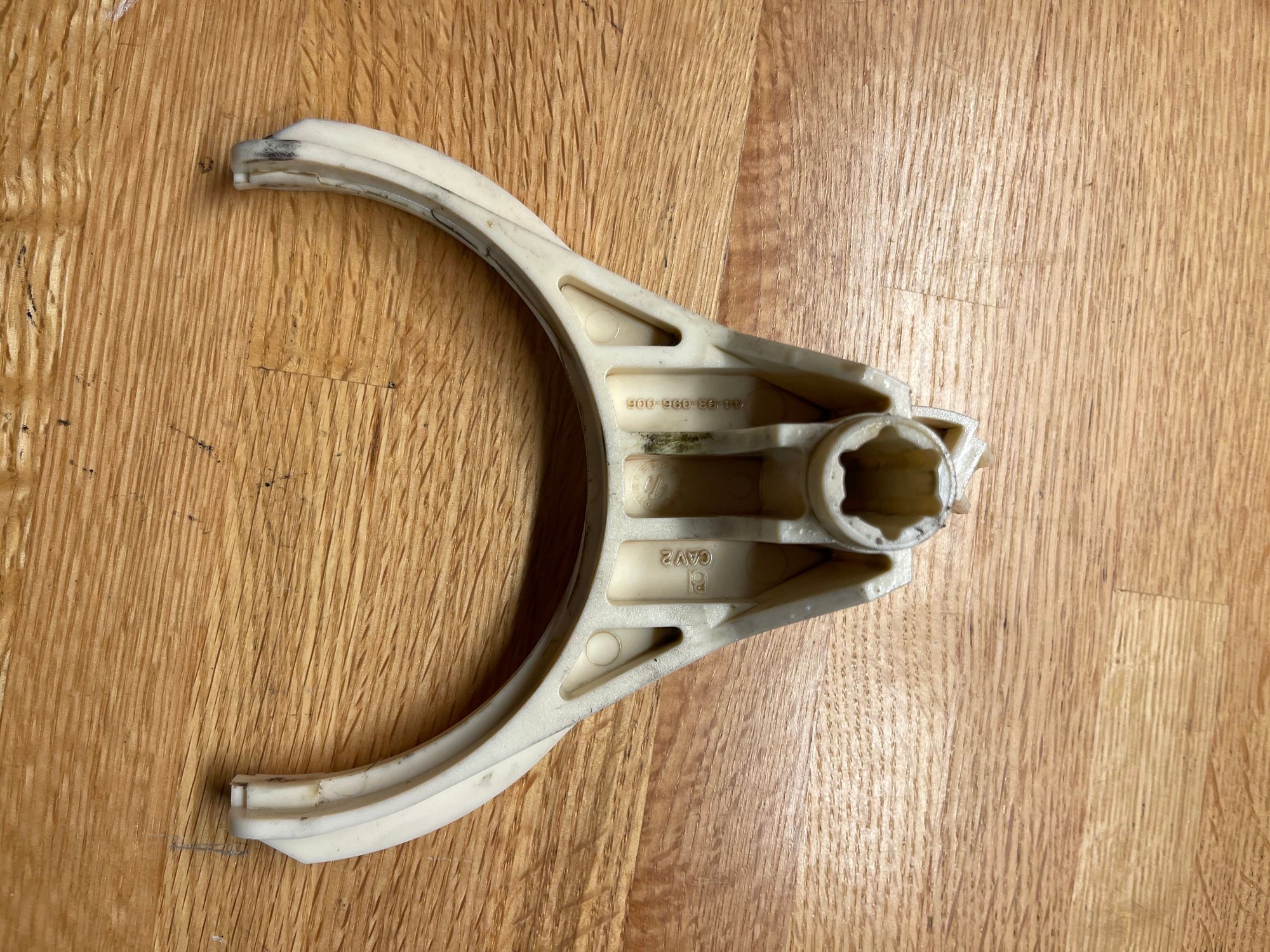

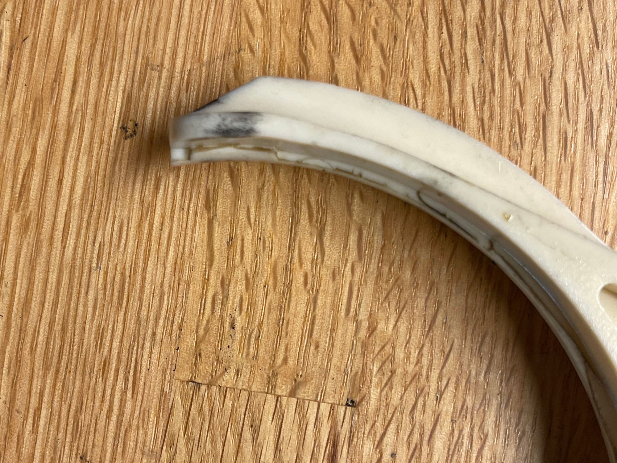

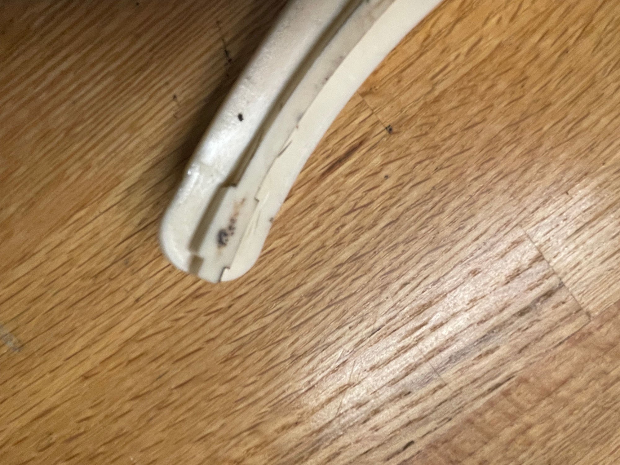

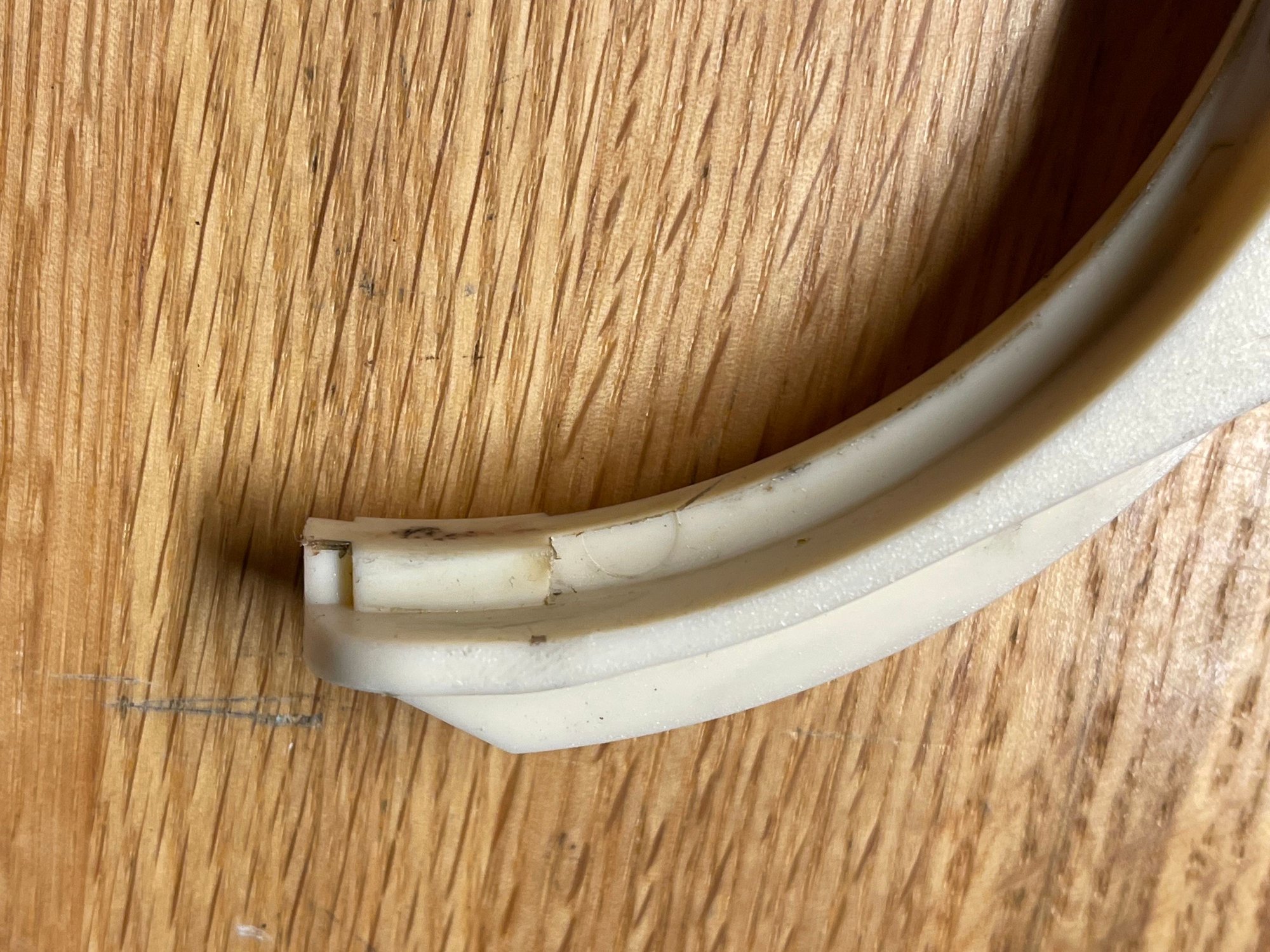

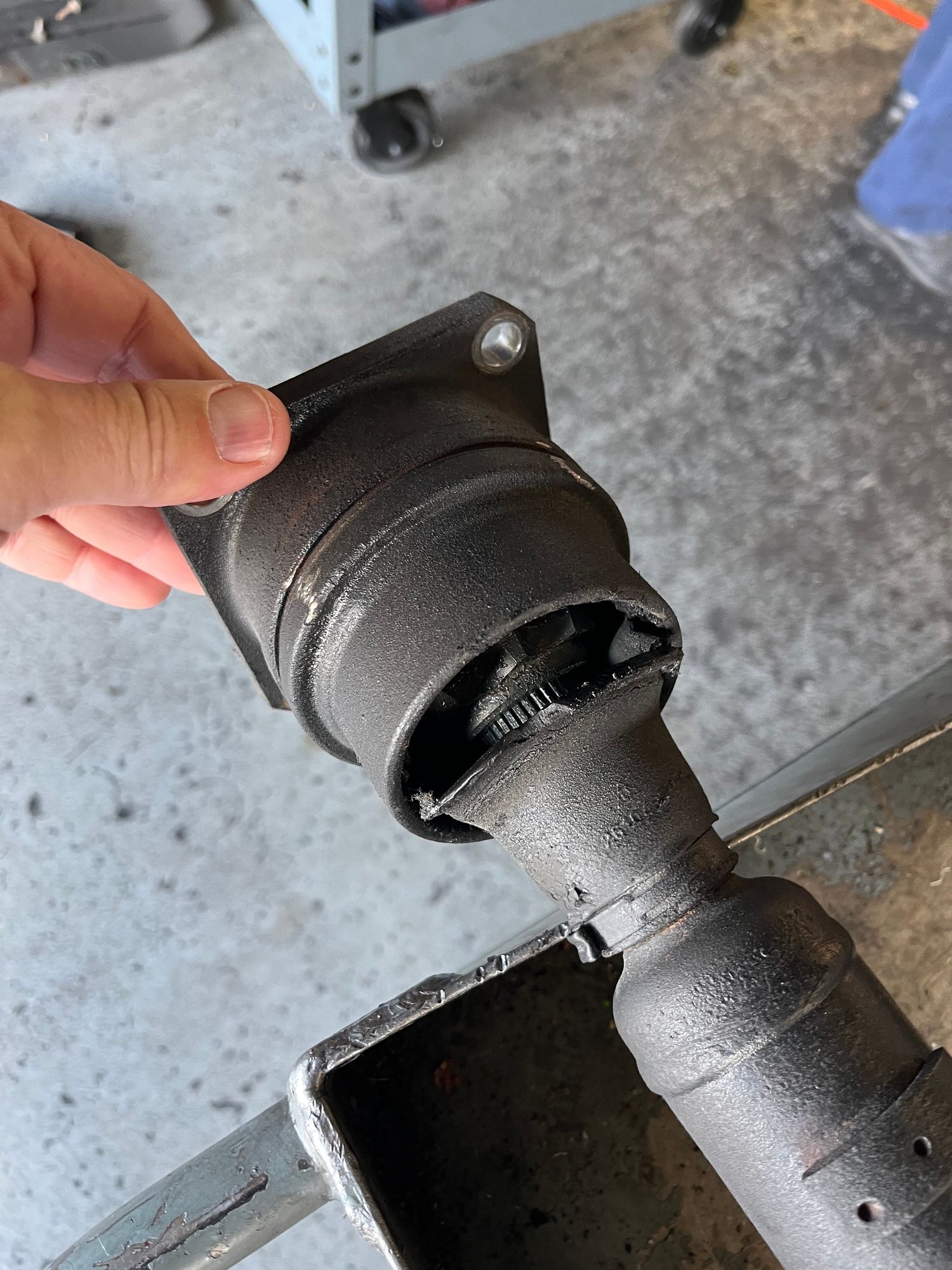

I want to share my transfer case experience. I could not make a sharp turn with my H3 and it seemed that the car is stuck and not moving and I had to back up the car and go back and forth several times to park the car. The car was driving very sluggish and heavy and sometimes I heard a load metal on metal clunk noise when making a sharp turn. I had this problem on-off. Took my car to four different mechanic shops (including a GM dealer) and each of them found something broken and changed it but did not solve the problem. I ended up doing google search and reading the Hummer forums about other H3 owner's experience and found out about the TC plastic shift fork. Finally asked a transmission shop in Mission Viejo and ask them to open the transfer case (and agreed to pay $400 to open the TC). Turned out that the jaws of the plastic shift fork are worn out, and the TC is locked in 4hi/low. There was a lot of debris in the transfer case and the TC oil pump filter was torn which was replaced. The shift fork was replaced by a GM metal fork (I chose GM fork shift instead of Dormann since had better online reviews). The drive shaft was also changed. The improvement in driving is very noticeable. I can make sharp turns without problem and the car seems to drive faster and easier. I think I have been driving in 4hi/low lock for weeks because of the shift fork malfunction. Here are some photos.

That is a nasty looking T Case filter sock and Front Driveshaft CV.
Are you still on the OEM Transmission? If not, when was that rebuilt?
