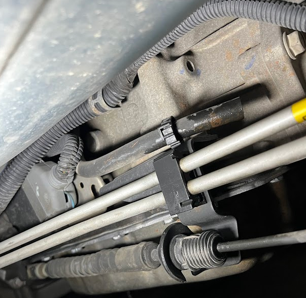

Completely forgot to add that I've been smelling trans fluid when driving the car, especially with the A/C on. It's a pretty strong smell coming from the vents. I can also smell it right after turning off the car and getting out. Can't see any active leaks, though. Everything is dry around the pan bolts and hoses leading to the bottom of the radiator. Not sure what to think about that.

If fluid is HOT/Boiling it will vent vapors out of the Trans Vent Hose = you can smell it. If that continues, fluid itself will blow out the vent and you will see it under the truck going toward the back. If that continues it will spew on the ground.
You are in rebuild territory if it runs too hot too long. Can you get a trans fluid temp reading with a scanner while drive at full operating temp?
The vent hose is definitely damp at the tip. Haven't noticed anything on the ground yet but that could be it. I went ahead and bought the AC Delco kit with the harness and got it in the mail today. I'll drive it one more time tomorrow morning and try to grab the trans temp reading. I can't seem to get the transmission temp through my code reader and apps, but I do have the Vident iLink 400 that can provide that. Although whenever I try to look through everything in that reader, all the electrical components just shut off and go dark. Never figured out if I was doing something wrong or what.
