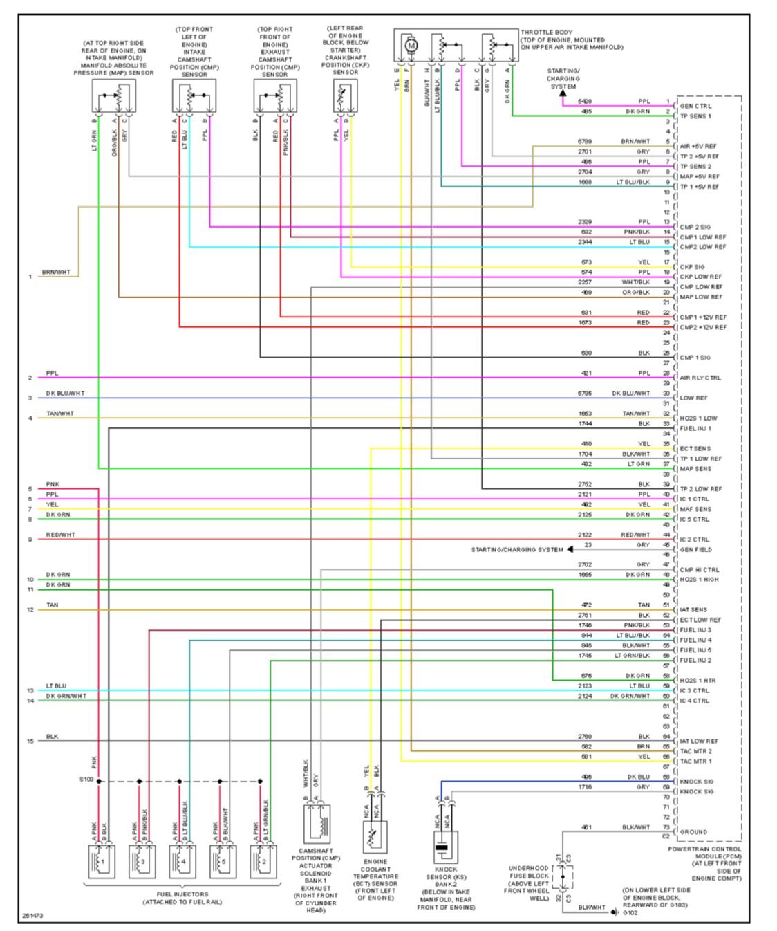

Okay so here is a pic of the wiring diagram but does anyone know what pin in the pcm does that goes to so I can check from there? And where else to check and do diagnostic to find where that short is

Posts: 3,206
what do you mean? the diagram you posted tells you that info right on it. the numbers going down the pcm are the pin numbers. it also gives you the wire color so you can cross check yourself.
Old Jul 12, 2024 | 10:02 AM
NFS's Avatar
NFS
Joined: May 2016
Posts: 739
what do you mean? the diagram you posted tells you that info right on it. the numpers going down the pcm are the pin numbers. it also gives you the wire color so you can cross check yourself.
I am sorry for the dumb questions.but I am not that good when it come to reading electric diagrams and electricity much. So the number on each side of the wire is the one that goes to the pcm?
the green black is 56
and the red is 5
how can I test it? And how do I find those numbers on the pcm pin to check?
