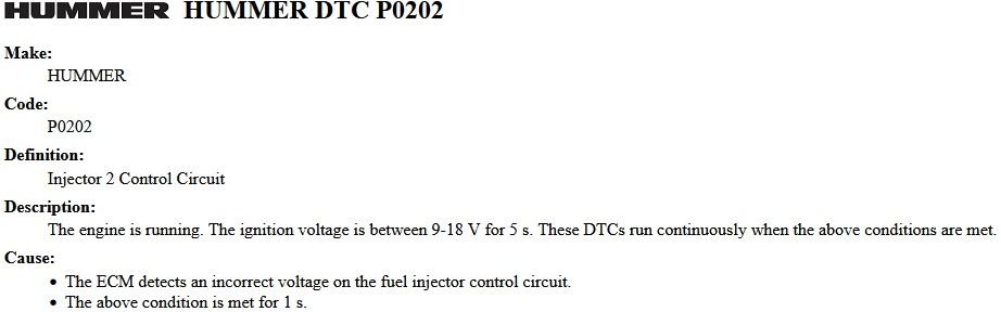

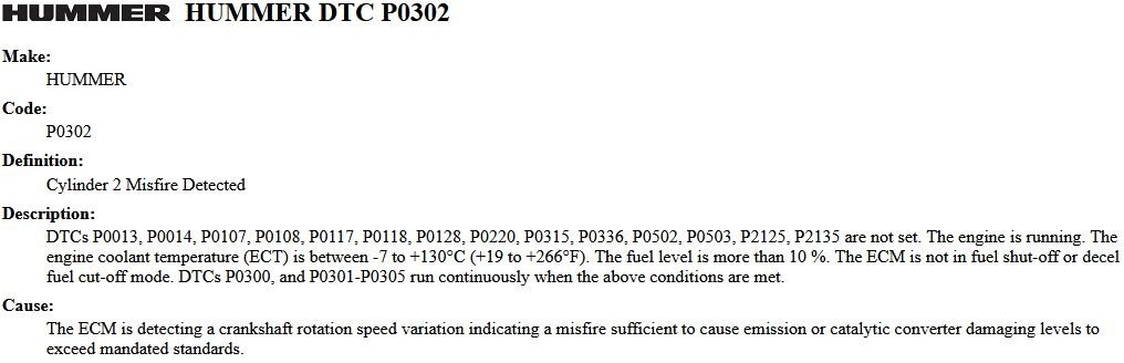

PO202 is a fuel injector circuit issue which triggers PO302. Check the #2 fuel injector connector and make sure it has clean contacts and properly secured.

Clear the codes, and monitor, first code up is your code to trace! 202 will trigger 302.

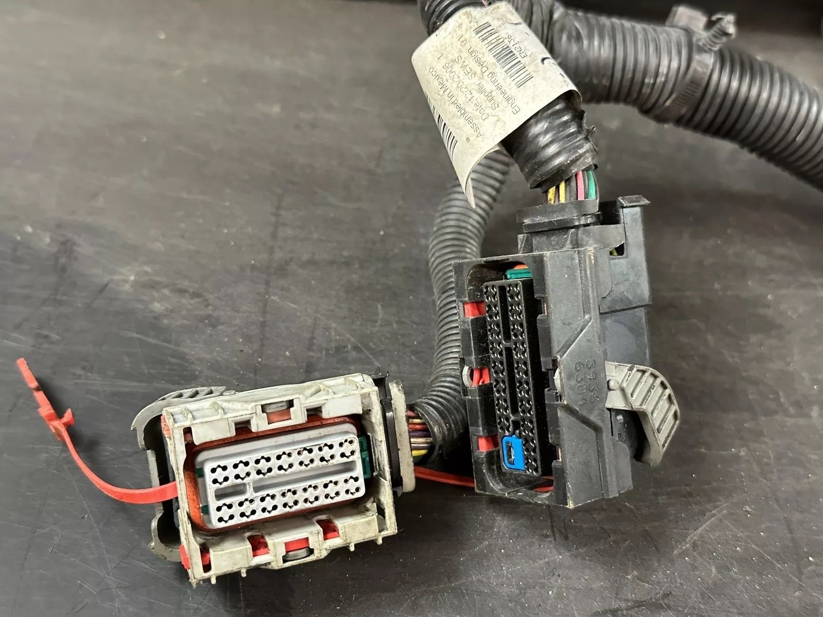

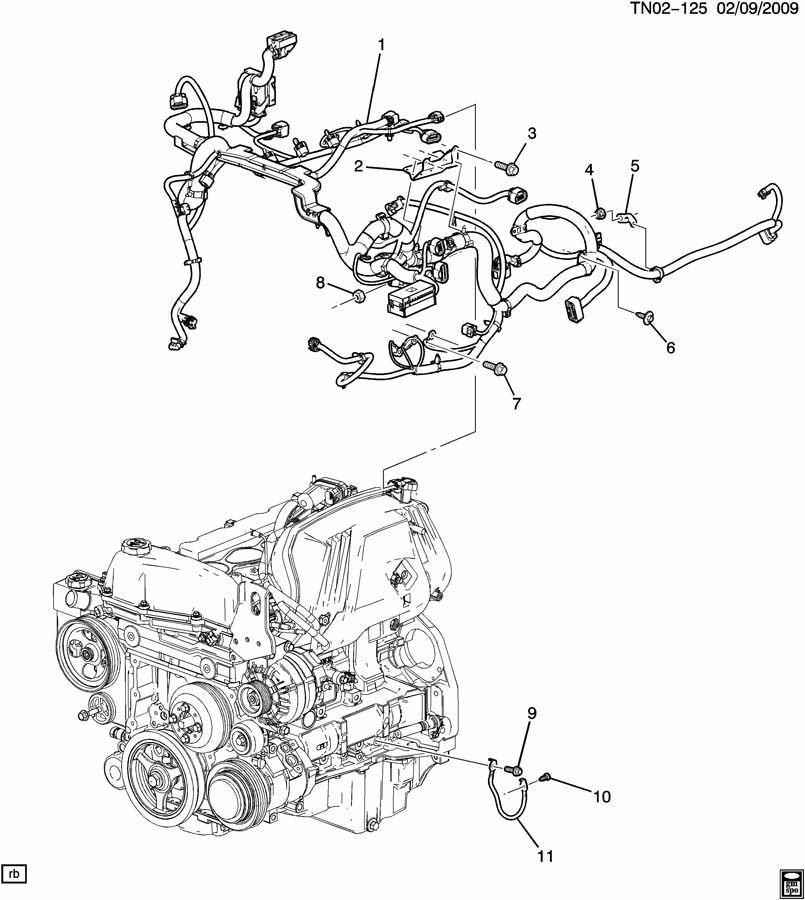

Check/clean contacts at the bulkhead connector.

I did but while I am driving it will come for like a sec and goes away I am getting code p0202 and p0300 now help
