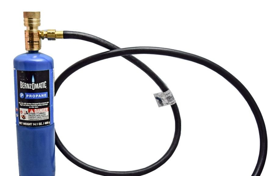

Did you check CK end play? You can test fuel system with a propane tank and a hose. Insert hose into cai, get an assistant to start vehicle(or get a longer hose), open the valve on the tank while cranking the engine. Will start and run until the propane tank goes empty, if not, there's another problem.
Whooa. That sounds dangerous.
I do not have tools to check CK end play. trying to find a local mechanic I can trust. Been working in older Bimmers for years and this chev block has be stumped.
