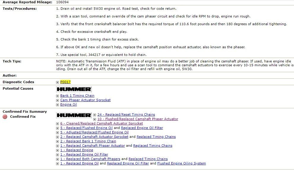

Stop throwing parts at it!
Here you go, a look in on my network of confirmed fixes:
(note: timing chain/sprocket replacement has highest count, next is the actuator, lowest is flush/replace engine oil)
Simple stuff first, then if all else fails, replace chain/sprockets. GL

Q for Hummerz: Have you seen cases where the timing chain needed to be replaced or adjusted and the ONLY symptoms were an error code and a vibration at idle? I have not, not that that proves anything. As for camshaft end play, I have no idea how to do that on this vehicle, but from what I've read if that's the problem you need a new engine or at least an engine rebuild, if the thrust bearing damage is repairable. If that's my problem then I'll just dump the vehicle when it finally dies. I'm not going down that road.
The part about using the scan tool to command it to do certain things sounds promising but my scan tool won't do any of that, unfortunately.
It sounds like the phaser/actuator solenoid thing has a high probability of fixing this issue for you, so my question about the AC Delco vs the no-names is still relevant: Is this a part where the no-name replacements tend to be crap?
So is all the ancillary info I've provided not relevant in your experience? You've told me to stop throwing parts at it, and I get that, but I spent less on that part than I would on new engine oil that was just replaced a few months ago? You have a lot more experience than I do with this truck, of course, so maybe all that other stuff I've listed really doesn't matter, I don't know. But it seems like it would?

I can only advise you on the steps I would take in your case(@180k miles, without knowing what oil you have been using?):
#1: Flush engine, refill with new mobil1 5w30 full synthetic & replace filter with AcDelco UPF61R
#2: Replace solenoid with ACDELCO 12615873
If code returns;
#3: Replace timing chain/sprockets.
GL
