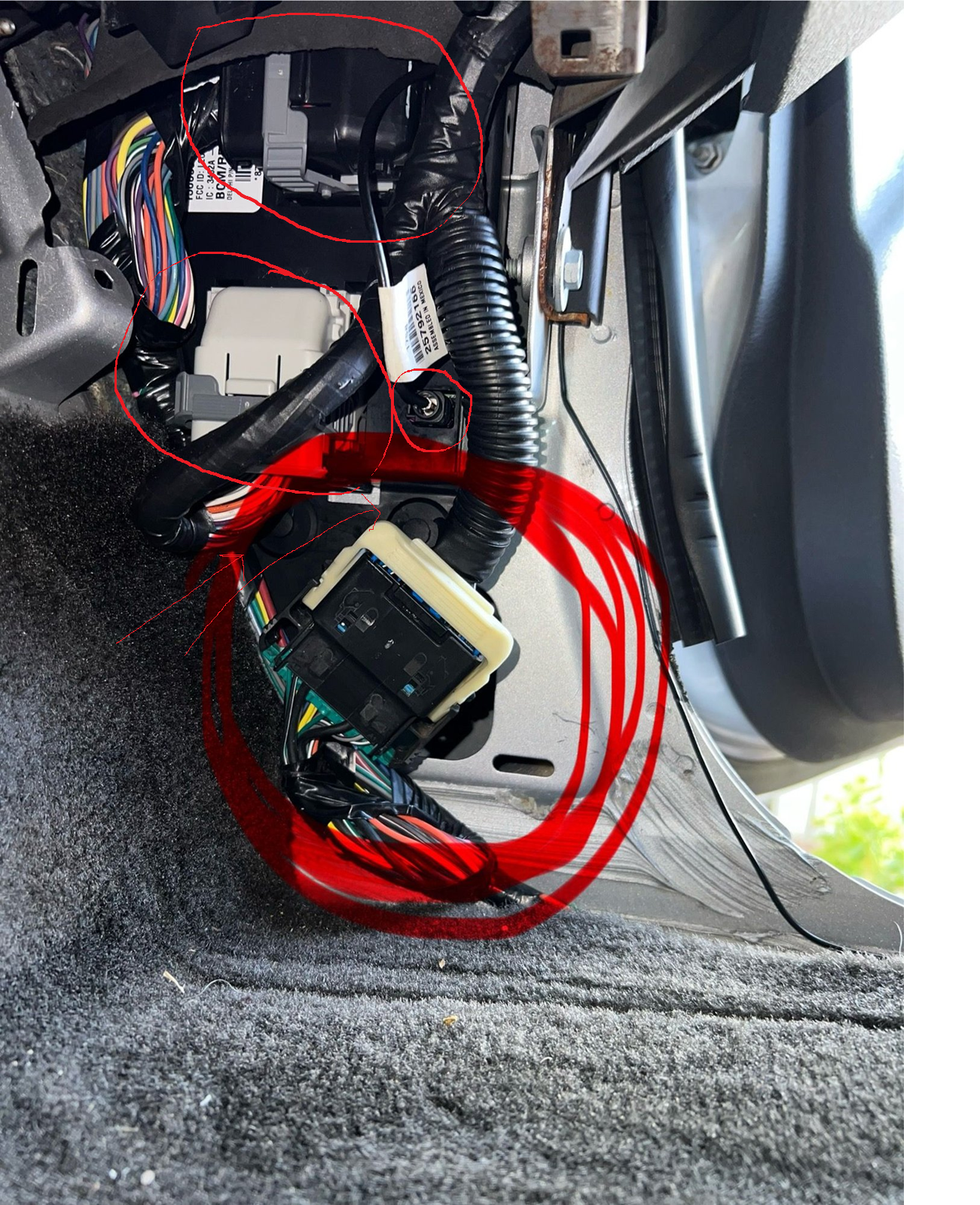

1. Battery Terminals - Doc already said it; replace the crappy OEM ones with an aftermarket brand if they haven't been replaced already.
2. Disconnect the Battery First then disconnect all three wiring harness connectors from the BCM, as well as the antenna for the Lock/Unlock/TPMS. Two of the wiring harnesses are attached directly to the BCM, and one is separate from the BCM. Physically remove the BCM from the vehicle by popping out the two grommet/fitting/things (red arrows in my photo, you have to pop out the small tip on the grommet first, then the larger circular piece will come out easier), then open the black plastic housing enclosure that the BCM sits in. Spray all of the wiring harnesses, the Antenna connections, and the BCM Microchip itself (both sides) with CRC Electronics Cleaner (do not use a similar product, use CRC). Apply some di-electric grease to the antenna connection.
Here is a video that shows how to remove the BCM (skip to about 2:10).
3. Re-connect everything, and see if that fixes your problem. If it does great, if it doesn't, post back here and we can help you out further.
4. To prevent this problem from happening again, definitely do the sunroof modification to the grommets to help with the flow of drain water. It's not hard at all, but having small hands definitely helps. Here is a great video by H3 Humper on how to do this.
Courtesy of NMH3
Courtesy of NMH3 from a different post. The three big circles are the three BCM connectors. The small circle is the TPMS/Lock/Unlock antenna. The arrows point to the grommets that hold the BCM in place.
Don't underestimate the power of simply cleaning all the electronic connectors, as well as the BCM itself; doing everything I did above was able to bring back my lock/unlock function on my wife's car (which does have a sunroof).
