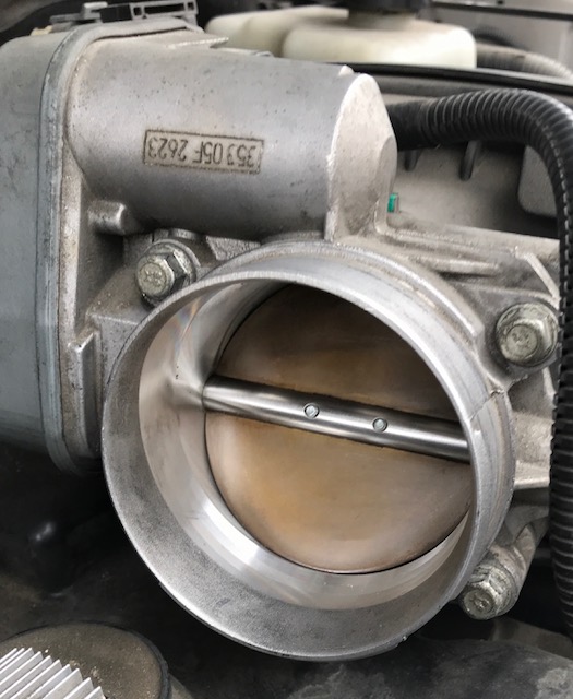

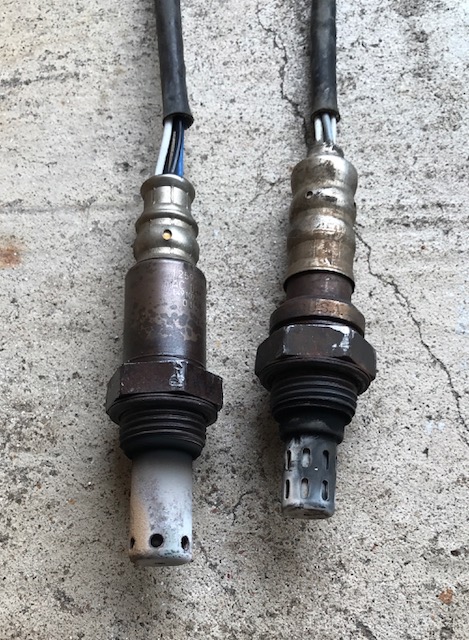

Thanks for the input. I spent some time under the hood last weekend cleaning the TB and replacing both O2 sensors. Attached a few pics below. The old O2 sensors look like they've seen better days.
Put everything back together and drove 80-100 miles. Check engine light didn't go off and didn't really notice a measurable change in performance. Still having problems starting. Usually takes at least two attempts. Again this week I had one instance where it took a few minutes of trying.
Took it back to AutoZone to see if the codes were any different. Still getting the P0171 code. This time though, it's also suggesting that I replace the O2 sensors, which wasn't suggested the first time I pulled the codes.
I used Bosch sensors in the replacement:
15131 (upstream)
15159 (downstream)
From what I can tell by searching the interwebs, those should both work with my vehicle. From other forum posts, though, I know that spark plugs are sensitive as to which manufacturer's parts are used. Is there a similar issue with O2 sensors?
I did notice on the upstream sensor, that while the connector was the same, the cable was a little shorter than I needed to run it properly. I had to use a bit of wire to keep it pulled up and away from the engine block rather than routing the cable as it originally was.

A quality O2 sensor should be fine, not the same issue as spark plugs.

I had to change my O2 sensor and it was hard to get off. I took out my MAF and cleaned it. Yours looks good but take it out and check the inside if you have not done so already. I stuck in iridium plugs. I cleared P0171 which I understand is a common code. For me the O2 sensor was the crust of my P0171 issue.

Those O2 sensors were indeed a challenge to remove.
