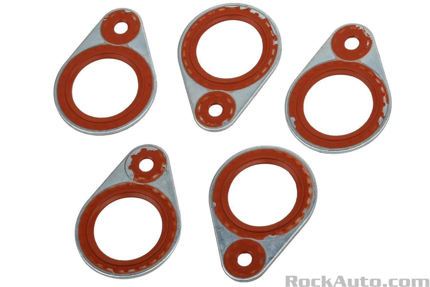

Oil Pump Pickup Tube O-Ring $14.30 and most of the day getting to it to R&R. It pays to wrench on these thing yourself.
