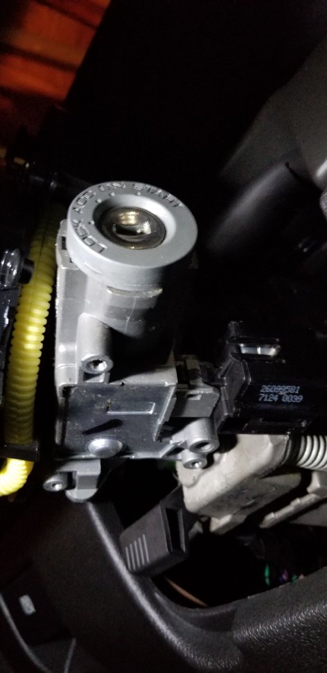

Default KOEO no power to gas gauge, temp or starter
I just tried and posted a video. No one on net has had this problem that I can find. That is the only reason I posted this. Hope to find the cure.

Do you know how to get to ignition switch?
yes, I tried a new passlock sensor that has 2 screws holding it on. Does same thing. I didn't replace the full ignition assembly. Looks like that has a rivet that needs to be drilled out to remove. Don't want to do all that and it's not the problem.

[QUOTE=hummerz;369909]Did you check for signs of rodent infestation?
I tried a new sensor and it didn't change anything. When you turn the key on you can see the gas and temp needles go down little more. So they are getting some kind of electric signal. Dies the sensor on the right of the ignition only control key functions? What fuse would power gas and temp gauges?

Sorry, does the sensor on the right contol anything but key lock?
What does this sensor control? Only key lock?
