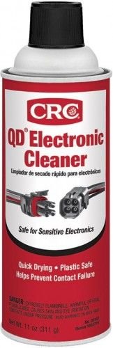

Take a look at your UFB. Make sure to be prepared:

Clean connector/ignition switch.
