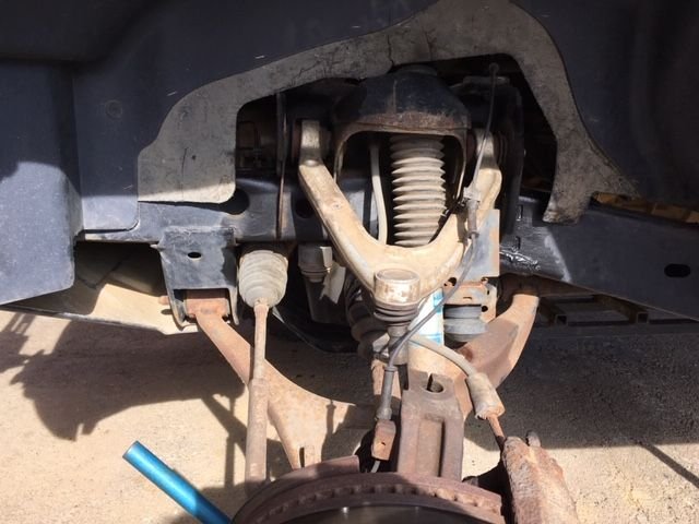

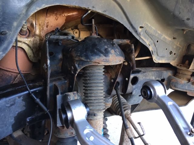

Job done, 3 hours job with new break fluid change
mew ones
got the old ones out
new ones in
finish

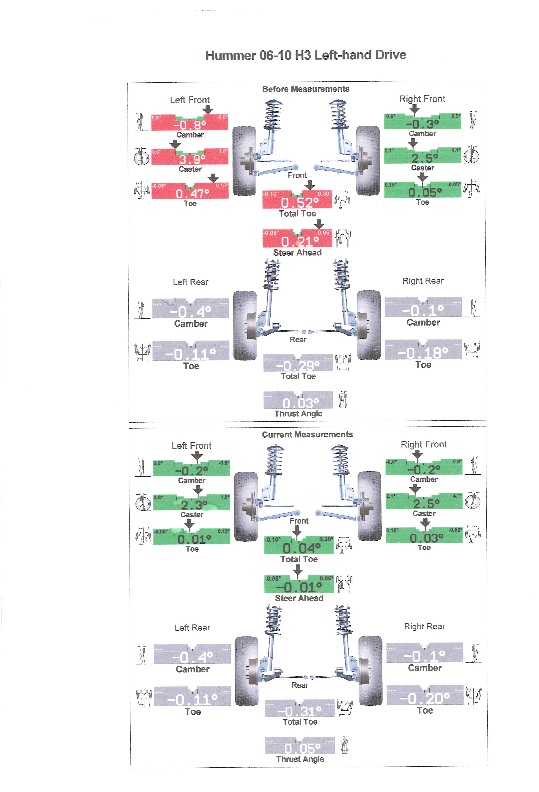

now just have to do a wheel alignment on Monday

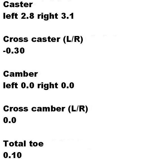

Nice work, now the most important part: the wheel alignment adjusted to oe specifications!
LHD specs. (reverse caster specs. for RHD):
Btw, get the final specs, and if you see this h3alignment, ask them to adjust again!

Excellent Thanks bro, i will take this to the garage
