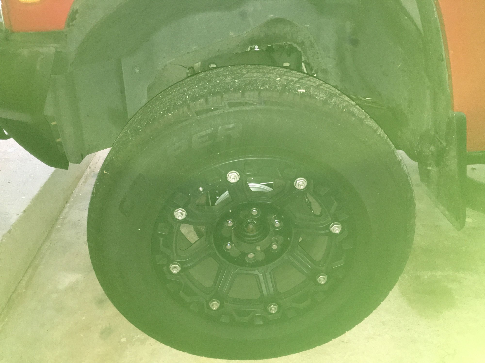

Id hate to say trash them How was the ride when you first got the Hummer, and with the old shocks? Did you put the 18 wheels on? What size tire is on the 18 inch wheel? A lower profile tire has a stiffer sidewall and can make the ride feel rougher over pot holes or rough roads. Maybe check all the things the other guys listed to see if any of those things are contributing to the issue.
when I got it honestly was super rough ride felt tired and wore out the original shocks was still on it at 192k it came with 18s on it they ate 275/65r18 tire pressure 40 it’s beautiful hummer bright red motor bay looked clean just seemed like nobody loved it

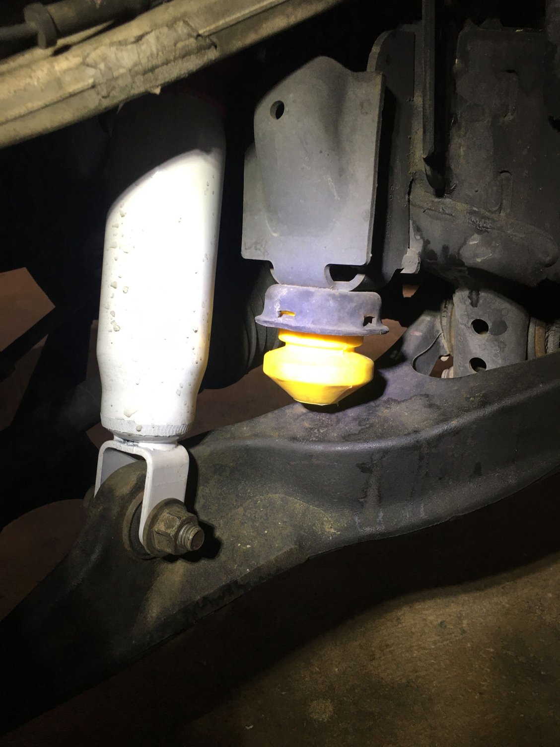

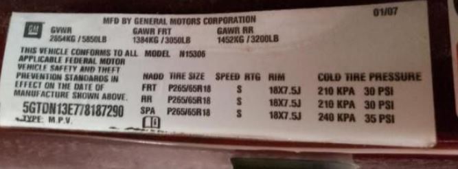

1. Lower the tire pressure. 30psi is what the door sticker says for the 18" wheels. Try 32-33psi.
2. make sure your progressive dampers are in good condition and not squished against the lower A arms. I have seen some that are just trashed.
They are in integral part of the IFS torsion bar suspension.

oh yea bump stops yep new front and back ok I’ll try lower tire pressure see how it goes I’ll look into shocks hate just bought these lol

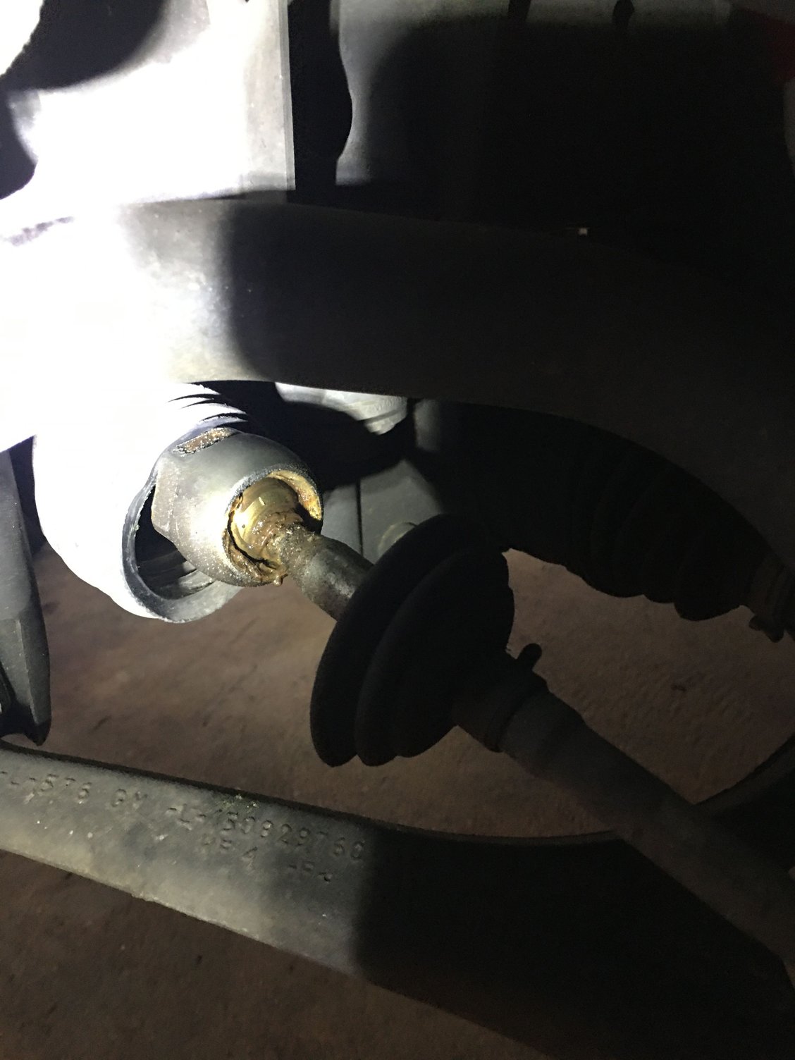

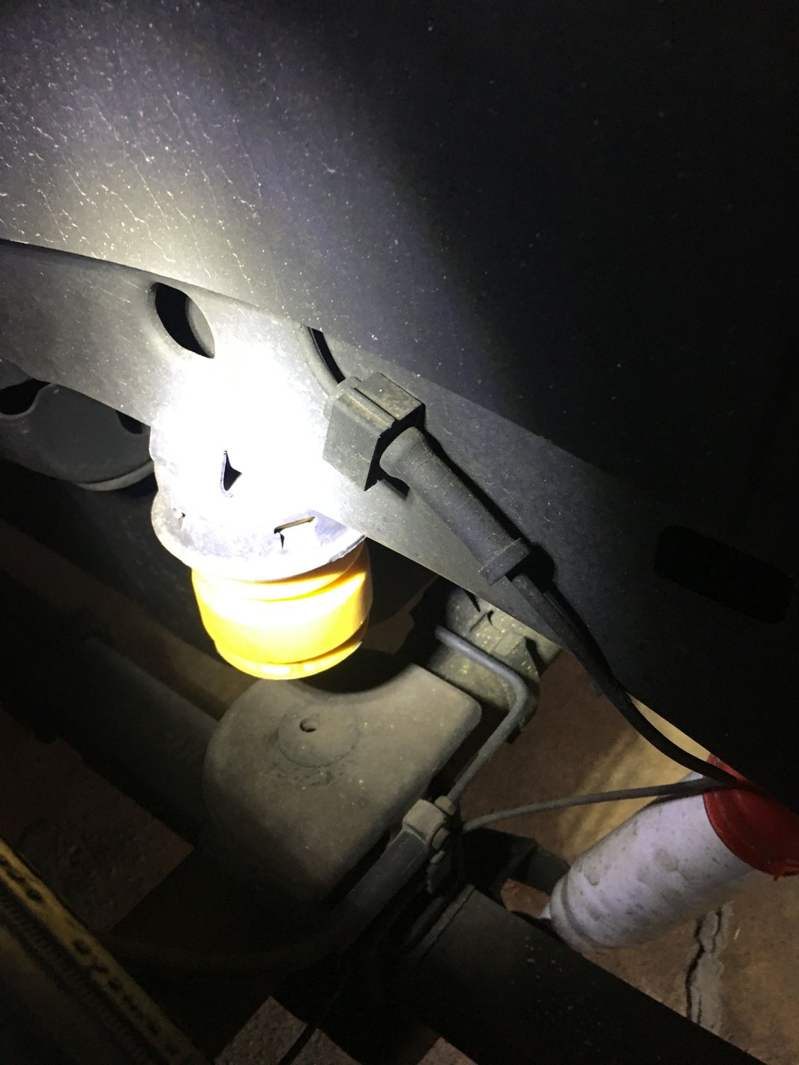

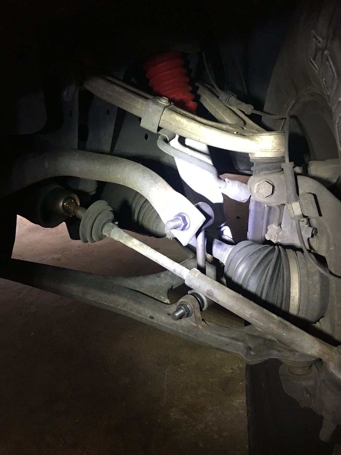

Post a photo of your front progressive dampeners (bump stops)
Old Mar 10, 2023 | 05:17 PM
Millertime045's Avatar
Joined: Feb 2023
Posts: 111
sorry was getting dark if need better pics lmk
Old Mar 10, 2023 | 05:39 PM
Posts: 9,018
R&P needs replaced.
s
Old Mar 10, 2023 | 05:54 PM
Joined: Feb 2023
Posts: 111
R&P needs replaced.
s
https://youtu.be/OG9jCjjIMr8
Ik doing both sides Monday already have parts just took pic showing it lol
Old Mar 10, 2023 | 06:22 PM
Posts: 9,018
R&P has 2 sides?
