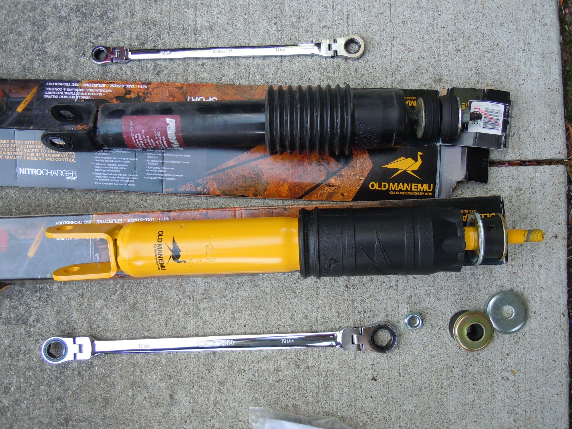

Having arrived on the H3 scene in Feb 2007, IMHO the best shocks for close to a factory ride and off road use combo are either the OEM ACDelco shocks that came on the adventure/off road package, or ARB OME Nitrocharger Sport set. The OME cost is about $50 more ea than the GM ZM6 suspension shocks, but I highly recommend the extra $$ as well spent. No shock is going to correct the problems that might exist that NMH3 suggested you review.
Tons of people over the years went the Bilstein route, most ended soon and unhappy as they are often leakers and wear out prematurely.
When I bought my 09 Alpha Off Road it had Monroe Reflex shocks, road like a truck, they were gone ASAP. Side by side of the Monroe and OME for the front. ARB makes quality beef with a substantially thicker piston rod!
