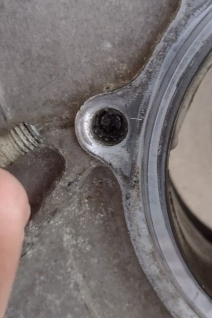

It's my fault for not double checking. But dang it! Replacing waterpump before I install new engine. Quick internet search for torque specs shows 22 ft lbs. My gut said no but I tried it anyway. Ended up breaking a bolt and making more work for myself.
FYI - the correct answer is 11.

Fyi-->89 lb in=7.4 lb ft.
I recently replaced my oem wp on my '07. Housing bolts were easy to remove.
