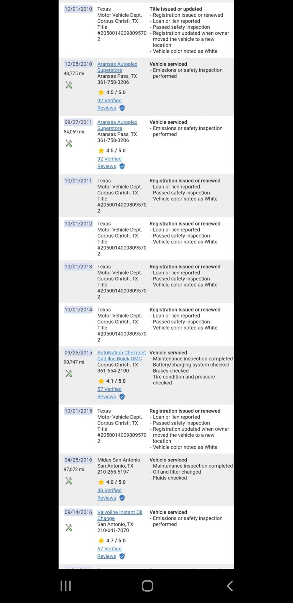

Yes once I put it in drive from park it is in 1st and shifts smooth through all the shifts as far as rpms go.. its an 06 and the carfax says it had 2 transfer cases replaced a month apart in 2007..the previous owner seems to have had maintenance done and had it serviced (is in really good shape for an 06) but shows no other work to the transfer case since the 2 replacements..
