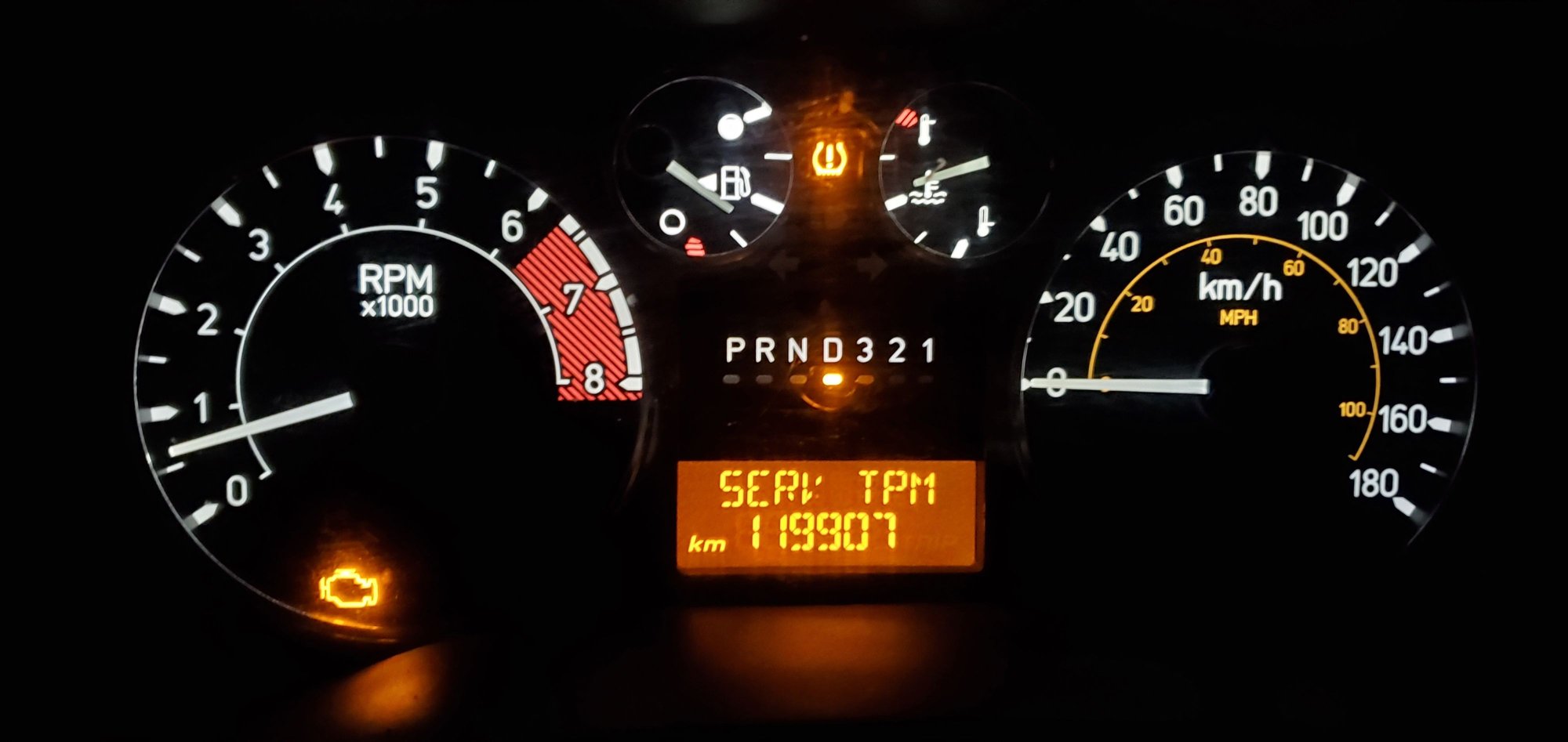

Just replaced upstream oxygen sensor, thermostat and solenoid circuit at evap control and my h3 was purr like a kitten, but just yesterday night it come out with new surprises...
New check engine light with some other problems (see picture)
Any ideas?
Cheers
Old Nov 28, 2020 | 03:40 PM
Broken Halo's Avatar
Posts: 1,461
The light at the top is a picture of a tire with an exclamation point. THAT and the 'SERV TPM' means to check your tire pressure. It's either out of spec or you need to replace the tire pressure monitor sensor. If you've never replaced them, your H3 is about 14 years old and the internal battery in the sensor/sensors is shot.

My tires are set on 38 psi cold. I already got the sensor from rockauto.com, but now the question whith one? How to figure?

Old Nov 28, 2020 | 05:29 PM
From experience, make sure to remove your spare and set far away from vehicle.
Then perform relearn procedure(if you don't get a response=dead sensor)

Apparently the vacuum hose got unhooked from the plastic thing, that connected to trotlle body.. hook it back , we will see what happens...
Passed the test from the video, Apparently all work. We will see if the lights will go on again..
