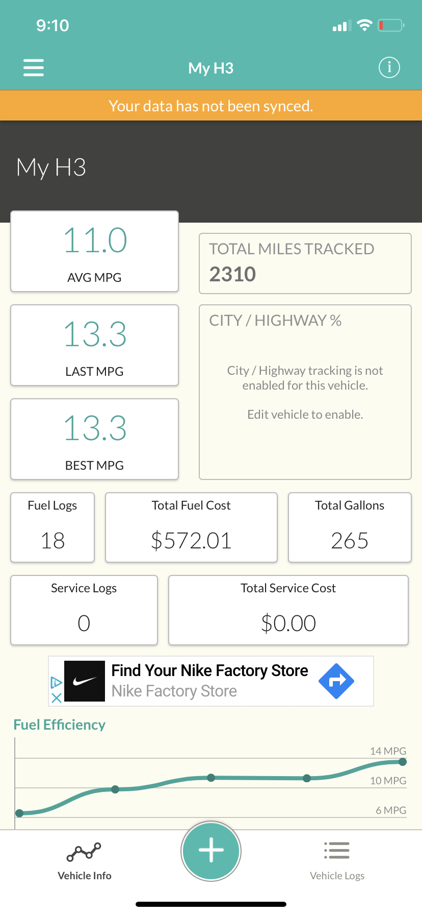

I got all the parts for front and back for about 174 from Detroit axle. So I am going to just do them both and knock it out of the park with a complete flush also. Then let’s say that isn’t my mpg issue any other suggestions? I mean I would be happy getting 14 around town
This is my mpg currently. The last was a highway trip about 150 miles.
