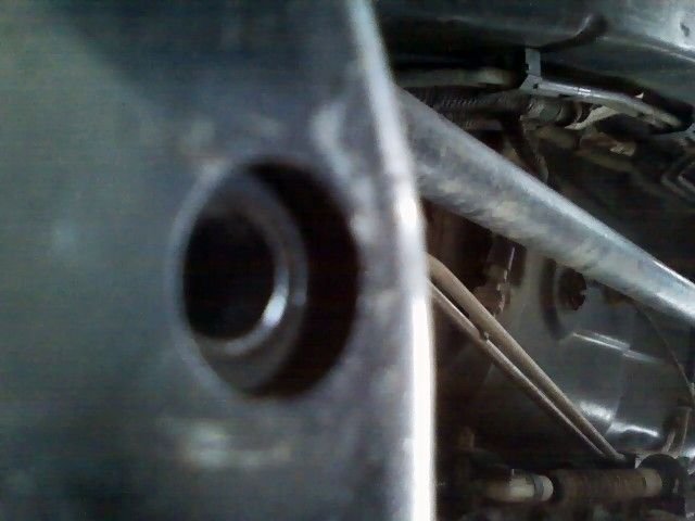

Missing Bolt on Rear Skid plate?
Old Feb 21, 2021 | 06:06 PM
Posts: 9,017
I strongly recommend to avoid compromise of structural integrity!
Old Apr 12, 2021 | 07:20 PM
Justinh's Avatar
Joined: Feb 2014
Posts: 477
From: north Alabama
Both of my rear skid plate bolts have weld nuts in the cross-member. It is not even possible to install U-nuts in these holes. The 2010's must be different. Now you've seen them all.
Old Apr 12, 2021 | 08:43 PM
Posts: 9,017
Not welded. Yes, U-nuts, or repair with
Nutserts Nutserts
Old Apr 13, 2021 | 05:45 PM
Justinh's Avatar
Joined: Feb 2014
Posts: 477
From: north Alabama
Not welded. Yes, U-nuts, or repair with Nutserts
What are you talking about? These are not U-nuts. The plate thickness is too large for a U-nut. I even had to repair one of the nuts with a thread insert because someone stripped the nut.
Also, the splash guard plate does not say "H3" and it doesn't have the top tabs to mount to like the previous year's models.
Old Apr 13, 2021 | 07:15 PM
Posts: 9,017
The front differential support is the same for all h3's. My H3 oe front support has a slot in the frame(see pics posted above) to install/replace the U-Nut. If your missing that, cut it then slide in a U-nut, or install a nutsert. Btw, I change my own oil, and all my U-nuts are still original.
Old Apr 14, 2021 | 04:11 PM
Justinh's Avatar
Joined: Feb 2014
Posts: 477
From: north Alabama
LOL - that should tell you something ...
Yeah, I do all my own oil changes also.
Old Apr 14, 2021 | 05:49 PM
Posts: 9,017
You got china steel? "someone stripped the nut"?
How did that happen? I'll stick with my oem differential support frame, and one day I may to replace the bushing, but still in great condition. I may need to pull out the gas wrench when the time comes.
Old Apr 21, 2021 | 11:44 PM
Brenton Tom's Avatar
Joined: Feb 2019
Posts: 9
Thanks guys. I guess I need to go a u nut and try to secure it with the bolt.
