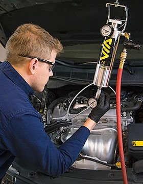

Find a shop that performs fuel induction service. >>>>>>>>>BG fuel induction service
