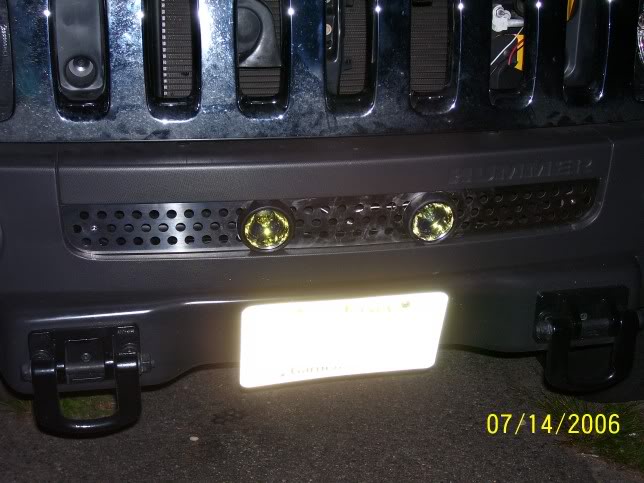

Sorry, rhill...I musta missed this thread....my bad. I never removed the lower gill. I did all the work while it was on the truck. I removed the main grill and had plenty of room to work on the lower grill. Leaving it in actually made life easier because it acted like a vise, easier to cut holes and work on everything.

Hey Mike; remember you said the battery air intake hose was your horn when we were talking about it? Your horn is pictured right there behind your grill on the left side.
What were you smokin' that day?

That horn was always there...but I also have another up where most have that ait intake thing. The power wire to that horn in the pic above is spliced and there is another wire loom running to the other horn...I'll take better pictures of it next time I am working on the truck.
