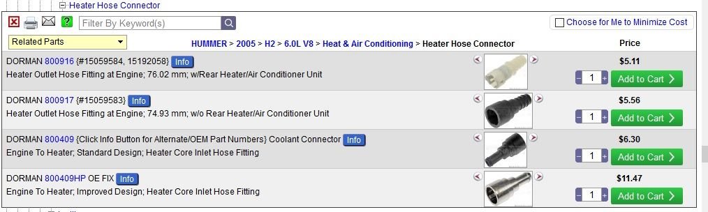

Autozone has the hoses. You will also want to get the Dorman (part numbers in hummerz post below) replacement connectors which is the plastic bit between the hose and the metal tube sticking out of the firewall. Same ones on all GM trucks and they eventually will fail but usually will break when you try and take them off...
If they dont list the parts specifically for a H2 you might need to have them pull them for a 2006 Silverado and visually compare to be sure but they should be the same.

The connectors are included with the hoses on RA also available separate.
Old Jan 13, 2021 | 04:58 PM
Ah - good call. Looks like those connectors are a slightly different size for the H2's.

I've also eliminated those connectors many times=1 less connection for a possible leak.
Slide the heater hose past the flare on the heater core tubes, far enough to secure the hose with a gear clamp, on the inside(firewall side) of the flare.
